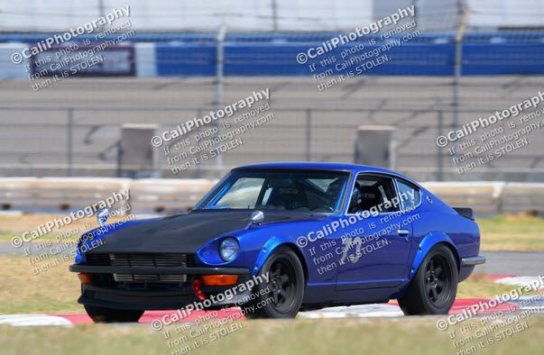

aongch Posted August 25, 2016 Author Share Posted August 25, 2016 Track pics from the Nissan Challenge: Quote Link to comment Share on other sites More sharing options...

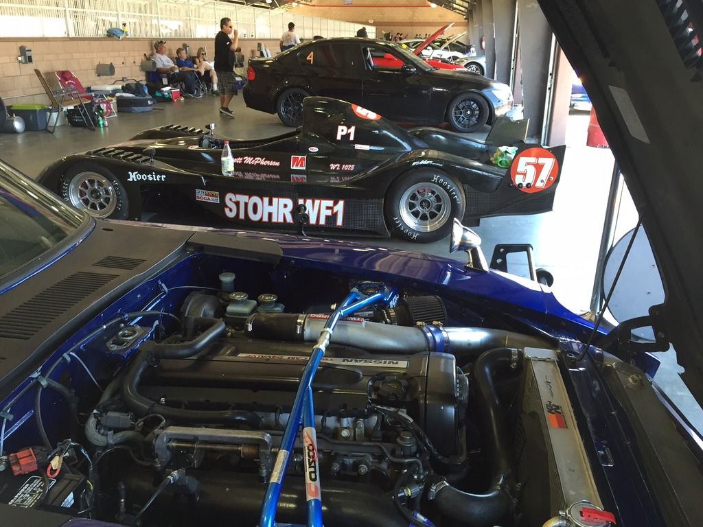

aongch Posted October 16, 2017 Author Share Posted October 16, 2017 Back posting again guys.....to update on the Quaife, it's working as it should on track, pulls hard on corner exits, no complaints on strange sounds, good so far. But reason for posting is, coolant seems to keep getting past the cap. I'm using the Arizona Z Car cross flow alum, and have used 13, 16, 20 lb caps, still not solving the problem. Pulled the plugs, looks good with brownish insulators, no oil burning. Although I haven't done any leakdown test, could this be a head gasket issue? It seems street driving doesn't give the same issues. Any ideas? Quote Link to comment Share on other sites More sharing options...
