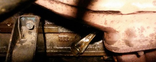

Project1 Posted December 31, 2014 Share Posted December 31, 2014 (edited) So first post here. I'm greatfull for all the info here. I have been waiting years to get a Z, so I'm more than super stoked to finally have one. I had a plan for my build, however in the first 300 miles of driving ...well pics worth 1000 words.I would love to go LS, but it's not in my budget so I found a L28 block for $80 and looks like I'm going to get to building.Any words of experience will be much appreciated.I picked up a few books, and I have been reading.What I'm thinking is:Block: flat top pistons, good rods, stock crank.Head: msa stage 2 cam, stainless valves, proformance springsBolt ons: msa header, exhaust, lone wolf manifold w/ fuel rail, supra injectors, mds box and coil.Trans: 5 speed train, and a good clutch and flywheel. EFI: M egasquirt EFI (in the learning process)So I was going to strip down this new block and bring it to the machine shop with the new pistons to get cleaned up and preped.Yes...no ... Any ideas ?And thanks again very happy this forum exist! Edited January 2, 2015 by Project1 Corrected title. Quote Link to comment Share on other sites More sharing options...
