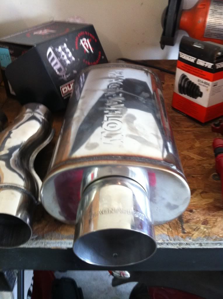

So my build is coming to an end. Spare wheel well has been cut out for the f body fuel tank, gauges are ready to be installed. One last thing at the VERY VERY end, is the exhaust.
I've heard a lot of people go 3 inch. I'm wanting to learn towards 3.5 single from 3inch collectors to a 3.5 inch y pipe through a resonator and a muffler. I really really want to avoid drone. And i REALLY want to avoid having to do a true dual out setup.
Here's what I got so far.
 4inch intake into stock ls1 from 2000 SS
sanderson block huggers from JTR, ceramic coated 3 inch collectors.
WANT TO GO TO 3.5 inch y pipe, to a resonator, and a muffler, then out.
What do you guys think? How would it fit under the s30 body? Am I looking for too much with a 3.5? ANY sound clips are welcome. I've been coming through youtube to find a good 3.5 inch exhaust note, but i've been seeing a lot of STATESMAN machines from australia.
PS, I want a smoother throaty sound than a cammed sound that seems to want to rip through the pipes. Maybe that has a lot to do with what tips? =T

Drone is almost inevitable with a dual system and no mufflers. However the note you get is just awesome. I have a true dual 3" system with an Xpipe and bullets at the very end (tips welded on the bullets) 3.5" would be tough to fit but it's possible. Your biggest issue will be wrapping it under the diff.
Edited by thezguy
Yea. I posted what I used in the description of the video. It's crazy loud. Once I get the interior back in, if it's still so loud, I will probably add resonators.
Do you have a muffler? Dual resonators did nothing more than clean up the rasp for me.

I have been listening to exhaust clips online. I'm liking magnaflo and dynomax. Mainly dynomax. Throaty, not raspy. I really hate the raspy sound. I'm not sure whether to do 3 inch collectors to a 3 inch y pipe to single out, or 3 inch collectors to 3.5 inch y pipe single through a resonator and a dynomax bullet. 3.5 from y collector out.
I have a slight drone in mine cruising in 6th around 1800 rpm on the highway. I'm looking into putting resonator tubes out from the exhaust to try out and see if it helps. Calculate the frequency and figure out how long they need to be then try it. I found it over on performancetrucks forum today. I'm running a dual 2.5 to single 3, then a 3 in/out Borla muffler.
http://www.performancetrucks.net/forums/sponsor-sales-specials-135/how-build-exhaust-resonator-tube-eliminate-drone-489463/
