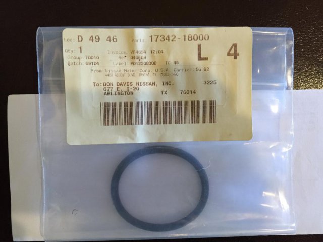

Phantom Posted February 28, 2015 Share Posted February 28, 2015 (edited) OK - I have the o-ring for the 280Z sending unit. It is still in the original plastic bag with Part# 17342-18000 that i got from Don Davis Nissan about 15 years ago. It appears to be in great shape - no cracking and still fexable. Since it may be the only one left in existence bids will start at $1,000. Edited February 28, 2015 by Phantom 1 Quote Link to comment Share on other sites More sharing options...
