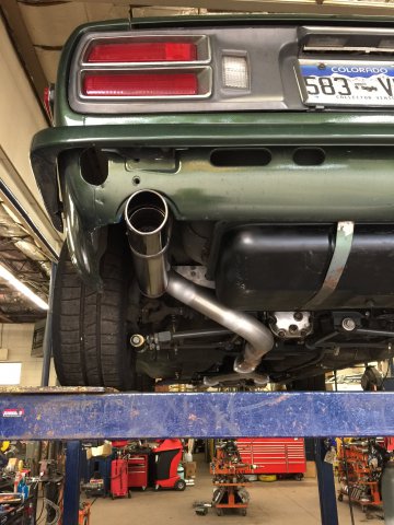

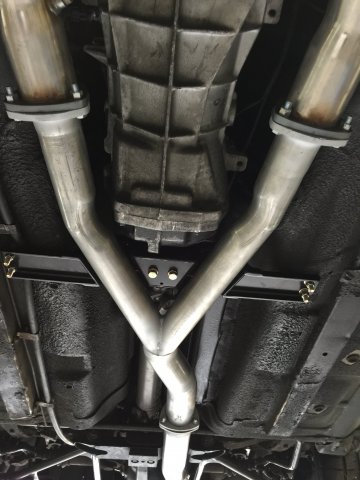

30 ounce Posted October 19, 2017 Share Posted October 19, 2017 (edited) I used Hoke Performance 240Z mounts for my late 260Z (280 chassis)with an LS1/T56 and it works fine. Hoke's new 280Z mounts offer more room for the exhaust system, I used Hawks (American Racing) headers and had to downsize the exhaust from the header 3" out to 2 1/2" then back to 3" to feed through the mounts. The 280 mounts should easily fit a full 3" system. It didn't seem to effect my power output though. The steering shaft is a tight fit through the headers too. As far as I can tell it doesn't rub. The other problem I had was the LS1 alternator is different than the LS2 I had to trim the back plastic cover on the alternator just a bit to clear the motor mounts. Edited October 19, 2017 by 30 ounce Added alternator info. 1 Quote Link to comment Share on other sites More sharing options...
