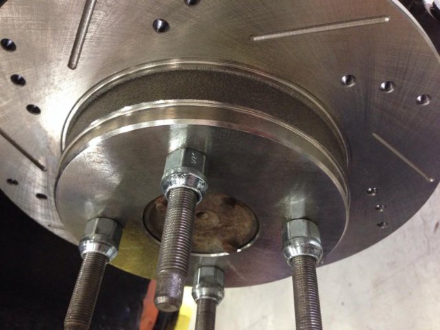

Hoover Posted March 24, 2015 Author Share Posted March 24, 2015 &^^^$Y$*%^^(^*&^*&^&^*^&^(*%& i was sent the wrong brake pads!!!!! rear wheel studs are loose......but that can be fixed momentarily!!!! Quote Link to comment Share on other sites More sharing options...

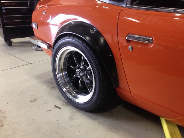

Hoover Posted March 24, 2015 Author Share Posted March 24, 2015 Before and after rear wheels Quote Link to comment Share on other sites More sharing options...

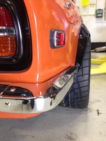

Hoover Posted March 24, 2015 Author Share Posted March 24, 2015 New lenses... Quote Link to comment Share on other sites More sharing options...

Hoover Posted March 25, 2015 Author Share Posted March 25, 2015 (edited) I'll need to check alignment and looks like the back needs neg. camber..... the wheels have a -19 offset and it's lines up with the outer edge of the fender flare....Maybe it should have been -17 offset? Edited March 25, 2015 by Hoover Quote Link to comment Share on other sites More sharing options...
