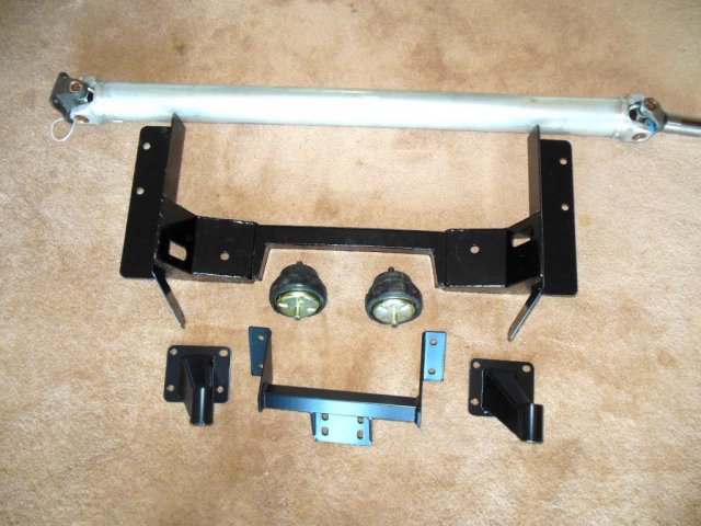

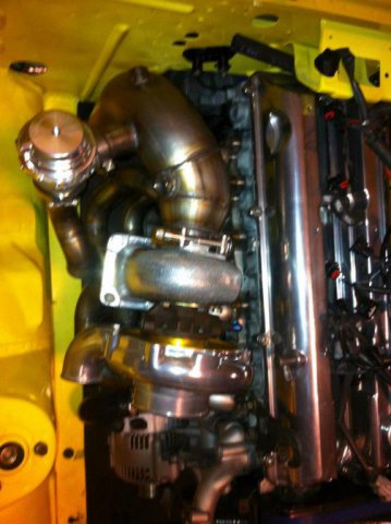

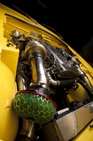

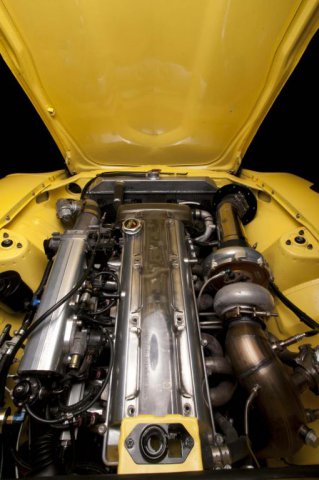

Nelsonian Posted April 9, 2015 Share Posted April 9, 2015 Furio, I have also been looking at Tech2's offerings as I am in need of all that their kit includes. Carlos is the one to speak with at Tech2 as he built their yellow 240z that is in some of their pictures. The only nit to pick I have with them is their website does not have all the pictures for their products, (something I mentioned to Carlos and was told to look for pics on facebook, etc..). I strongly feel that if you are trying to sell a product you should provide the prospective purchaser with as clear a view of the product and not have them go searching for pics to visually see how it fits. My concern is how far back and low does the engine mount. As far as Wiring specialties goes, I am about to complete my order of custom harness wired to Haltech ps2000, flex fuel sensor and other Haltech parts. Dealing with Yury has been a breeze. He has answered all of my amateur questions and is still honoring his November "black friday" sale price that I originally started with. Here are some pics of the Tech2 car I found. Quote Link to comment Share on other sites More sharing options...

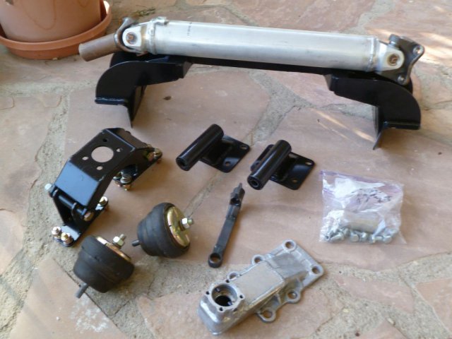

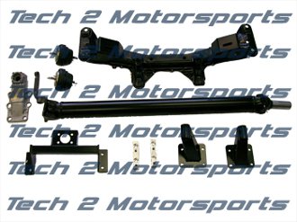

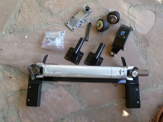

Nelsonian Posted May 23, 2015 Share Posted May 23, 2015 (edited) Just wanted to state that if anyone is considering the Tech 2 mount kit be forewarned that the picture of their swap kit for the 240/280z is actually for another make of car. This picture included, shows the proper kit, (with the optional aluminum driveshaft). I just checked with Carlos of Tech 2 to have confirmation that what I purchased from the individual Ebay seller was actually for the 240z as it was different from the web site's picture. This is a bit annoying for any potential consumer to have to dig for proper pictures and info on a web site that is all out of whack. First pic is their Wrong provided pic for the 240/280z kit. The one I provided above is correct. Edited May 23, 2015 by Nelsonian Quote Link to comment Share on other sites More sharing options...
seattlejester Posted May 27, 2015 Share Posted May 27, 2015 Thanks for the pics, that solves the question of what they do for the transmission mount, seems like they sell you some plates so you can just drill holes and bolt it into the tunnel and bolt to the plates. Congrats on the snipe! Quote Link to comment Share on other sites More sharing options...

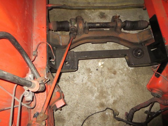

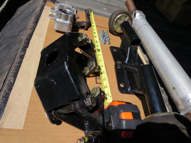

Furio Posted June 3, 2015 Author Share Posted June 3, 2015 Just wanted to say I bought the kit and it has arrived. So far it seems pretty good. It was a wee bit rough but I think that was purely from the shipping. The welding and overall build quality seems really high. Finished ripping my v8 out the other night, need to cut some old mounts off with the grinder then I'll go about test fitting the new kit, should be interesting to see. Rubbish pictures but you get the idea. Quote Link to comment Share on other sites More sharing options...
