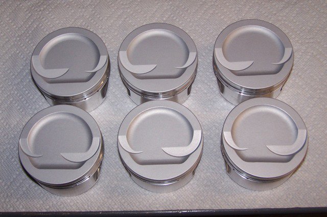

DAW Posted April 26, 2015 Share Posted April 26, 2015 (edited) Here is what I am referring to: ...the table on the piston top is juxtaposed to the table on the cyl head = squish/quench, etc = high c.r. resistant to knock. Edited April 26, 2015 by DAW Quote Link to comment Share on other sites More sharing options...
madkaw Posted April 26, 2015 Author Share Posted April 26, 2015 Dam, that's a hell of a shelf on that piston. Those aren't stock flatops right? Yes, we are talking about the same thing as far as cutting the shape of combustion chamber in the top of the piston. I was Suprised to see that you also needed room for valves with additional reliefs . What engine and head combo? Quote Link to comment Share on other sites More sharing options...
DAW Posted April 26, 2015 Share Posted April 26, 2015 they aren't custom pistons, they just happen to line-up flat-to-flat tables. Pins are 21mm; c.ht is 34 mm. After fly-cutting, the intake eyebrow would match symmetrically to what you machine in next to it...the identical eyebrow. It is an experiment but seems sound. Quote Link to comment Share on other sites More sharing options...

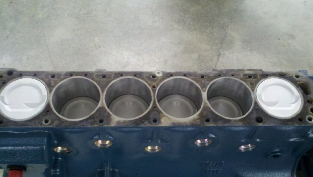

inline6 Posted April 26, 2015 Share Posted April 26, 2015 Here is what I am referring to: ...the table on the piston top is juxtaposed to the table on the cyl head = squish/quench, etc = high c.r. resistant to knock. Those look a lot like the JE pistons in my engine. Quote Link to comment Share on other sites More sharing options...

DAW Posted April 26, 2015 Share Posted April 26, 2015 Those JE pistons do look similar. See how three are the reverse configuration re exhaust/intake reliefs? The problem with using pistons from a V6 in an inline six engine is that three are going to be the wrong piston pin offset for the rotation direction. That's why I was going to cut the exhaust valve reliefs to be symmetrical to the intake valve reliefs on all six pistons. It is a compromise but not giving up much for the sake of attaining good squish and keeping c.r. useable on high displacement engines. I hadn't considered valve-piston clearance as even an issue in what I'm referring to because it looks like there is plenty there. (In that sense I hijacked the thread) Again, this is more of an issue on L4 engines because there are no raised roof/closed chamber heads available for L4 as there are for L6. Anecdote: I bought a rather hacked up road race 510 years ago, 1600 cc, and I had the head off for some reason and noticed that there were nicks in the piston tops on #2 and #3 cylinders from intake valve contact (not enough to bend the valves). That was because PO had the #2 and #3 pistons assembled into the wrong holes. They were nice forged pop-up pistons. I reversed them in their holes, sorted some other things out, and raced SCCA Solo I and II with the car. PO was a dyslexic engine builder I guess. Quote Link to comment Share on other sites More sharing options...
