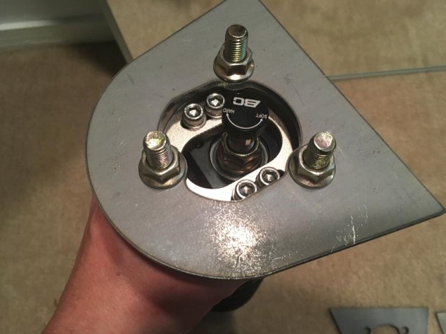

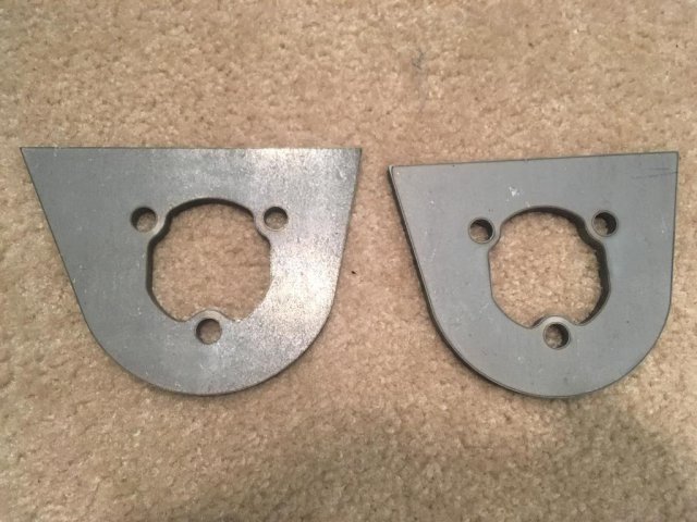

theczechone Posted June 2, 2016 Share Posted June 2, 2016 My strut towers have been modified one too many times so I had some plates made up to weld on top of the towers. With these I can go back to stock suspension too. Quote Link to comment Share on other sites More sharing options...
seattlejester Posted June 3, 2016 Share Posted June 3, 2016 Those came out nice, I would have really liked the extra width to adjust it without having to drop the struts. Although if you are welding tops in, you loose some of the value the BC coilovers provide in being straight bolt in. Quote Link to comment Share on other sites More sharing options...
theczechone Posted June 7, 2016 Share Posted June 7, 2016 I don't see the "bolt on" property of BC coilovers as a value or a reason to buy. You still have to get the threaded sleeves welded so it's still not a bolt on part. Went with BCs because they're a well established company that makes good parts. My strut towers have already been hacked on numerous times. So i could weld on a camber plate or go this route which will allow me to go with stock setup if i choose to do so at some point. If anyone would like the cut pattern for the hole in the center i can provide a template for cutting the stock towers. Quote Link to comment Share on other sites More sharing options...
seattlejester Posted June 7, 2016 Share Posted June 7, 2016 I wouldn't mind having the file. Or posting it up could be helpful for others. I wonder if the stock tower is thick enough with the material removed away like that. I've seen others cut slots to adjust camber between the bolt holes just to access the allen head bolts. Pretty cool regardless. Quote Link to comment Share on other sites More sharing options...
