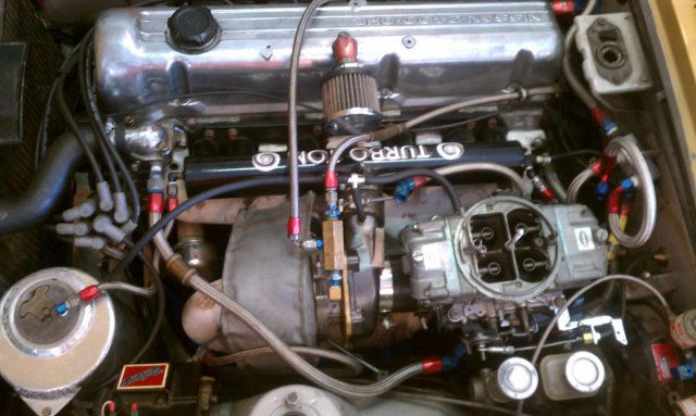

texis30O Posted April 22, 2015 Share Posted April 22, 2015 (edited) With my Turbo Tom kit @10lbs and a severe boost leak I was at 326. I think you have more in her. What are your plugs gapped at? EDIS should gain you some good tuning. What other head work d you have? My set up was all tapped out at 18lbs of boost but I never pushed it to that. I swapped the motor out for a LS. Hopefully this is a start for you to use. Keep it going. Edited April 22, 2015 by texis30O Quote Link to comment Share on other sites More sharing options...

texis30O Posted April 23, 2015 Share Posted April 23, 2015 It was a RayJay unit. Quote Link to comment Share on other sites More sharing options...
texis30O Posted April 23, 2015 Share Posted April 23, 2015 I don't have the info on it any more. Quote Link to comment Share on other sites More sharing options...
Tony D Posted April 26, 2015 Share Posted April 26, 2015 With or without the squeeze Texis30O? I thought you posted Dyno sheets in your build thread? Quote Link to comment Share on other sites More sharing options...
