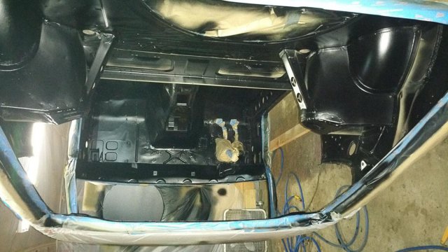

JoeK Posted May 13, 2016 Author Share Posted May 13, 2016 I've been sick of not being able to find the time to paint the interior. Basically the last thing I wanted to do before I take the car off the rotisserie. So, today I called in sick to work and painted the interior. I went with a matte black. Now to order up some wheels and tires, and get this thing back on the ground. Quote Link to comment Share on other sites More sharing options...

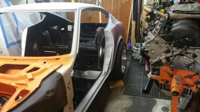

JoeK Posted August 18, 2016 Author Share Posted August 18, 2016 (edited) Big day. That tire is on the ground. Yep, she's off the rotisserie. Couldn't put the front wheels on, the lug studs are too long but I'll cut them shorter this weekend and get it all the way down and resting on 4 wheels. I had borrowed an extra engine hoist from auxilery, but it turned out the wheels wouldn't fit underneath my rotisserie, so I couldn't get the hoist over the lift points. So I constructed a simple overhead beam structure and dropped it down using 4 come alongs. Very happy to be able to move on to the next part of the build. Edited August 18, 2016 by JoeK Quote Link to comment Share on other sites More sharing options...

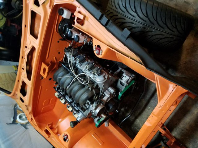

JoeK Posted February 12, 2017 Author Share Posted February 12, 2017 So this happened today. A big thank to auxilary for taking to day to help me get this thing shoehorned in. All went pretty smoothly, needed to slot the motor mount to get a little more angle in order for it to be aligned straight, and some small adjustment to the trans tunnel. Also had to cut some bosses off the side of the MN12 T56 trans. Quote Link to comment Share on other sites More sharing options...

JoeK Posted January 12, 2018 Author Share Posted January 12, 2018 It’s been 6 months since my last update. I’ve been getting stuff done, working steadily but still no leaps or bounds. Until last week when the family decided to visit family on the other coast and was kind enough to leave me behind. I was able to really tackle and complete some loose ends. Got the engine harness worked out. It had trunk lines that seemed long enough to put in a truck, and I wanted to move a few things around. So pretty much took it apart, sliced and diced it, a little shortening here and lengthening there and voila. A harness I sure as hell hope works. I made a boxed mount for the ECU and got it tucked up nicely next to the blower motor. I restored the entire HVAC system, and got that reinstalled. Rebuilt heater core, fresh paint, upgraded blower motor from a Kia. Radiator and fans mounted. All hoses run. Went through a lot of hoses finding what would fit. What worked for others didn’t seem to work for me. Ordered 3 different 45 degree thermostat elbows, and they all showed up with 60 degree angles. Still not sure if I like the location of the steam fitting and vent in the upper hose, might move down so at least it’s horizontal so I can get the air out of the system (if I ever get to that point). finished the majority of the cold air intake. Still need to mount the air filter, which arrives tomorrow. I have an adjustable stiffener arm by Spectre that I hope will work to hold the filter up. It just doesn’t seem like it will be that stable otherwise. Made a shifter boot out of neoprene and a retainer ring out of sheet metal. Had to hack a substantial amount out of the center console to make it fit over the MGW short shifter, and will need to figure out an interior boot at some point. Restored the dashboard and am really happy with how it turned out. We’ll see how long it lasts. 5 new Speedhut gauges, with new Millhouse pods for the smaller gauges. Sound mat on the entire interior. Used Rattletrap extreme. Great bond, same thickness as the big well known stuff but half the price. I don’t really know effective it will be, but certainly can tell the difference when knocking on the panels. Camaro tank installed, plumbed and wired. Just need to get fuel gauge worked out. Next up is the body harness. Have a 20 circuit EZ Wire harness and am trying to get my mind into it. Electrical is kinda my kriptonite, it makes me weak in the knees. Then I guess it’ll be time to throw some fluids into everything and see if she’ll start. Quote Link to comment Share on other sites More sharing options...
