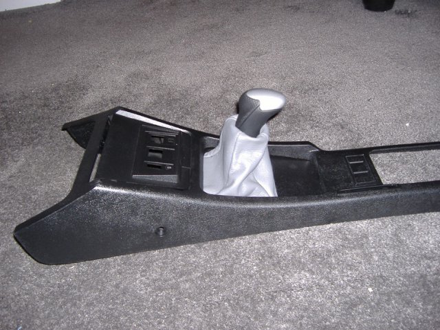

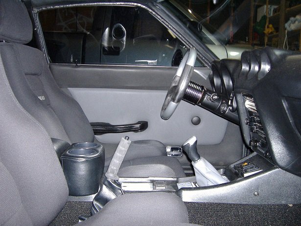

I have a couple more, but lets start with these and hopefully reading the manual should answer most of them. Mostly stumped on the t5 trans fitment to what other engines. I've been reading a lot on hot rod forums but haven't exactly found an answer. Much of what you ask is covered in the JTR book. Keep searching the archives and Google concerning the T5. The T5 is angled 15 drgrees towards the dirver's side. Use the T5 bell housing (BH). If you use a chevy bell housing other than a T5 then the rear trans mount will be twisted15 deg. from level which means that you will have to make an angled trans mount. Using the T5 BH you will need to trim trans tunnel a bit to clear the shifter on top of the trans. No big deal. I have done two and once the center console and shifter boot is installed it looks normal. Also, you will need to shorten the shifter. I suggest you buy books for Chevy engine building/swaps and also the T5 transmission.
