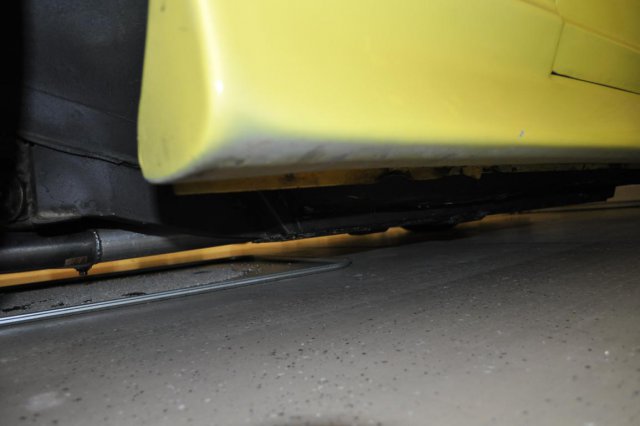

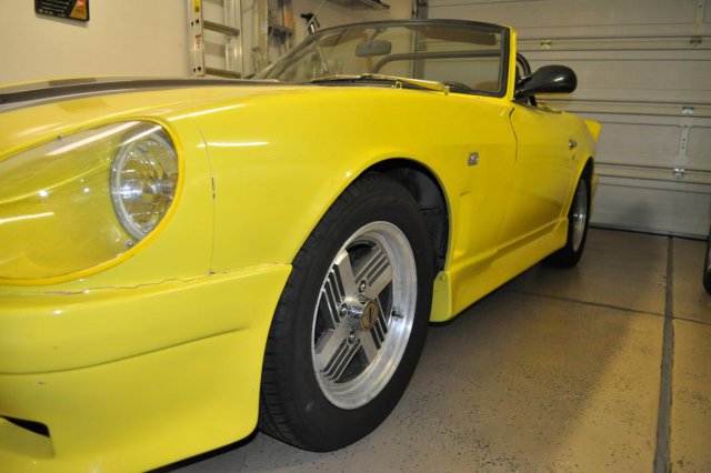

Ride height:  I didn't know where to measure since there is an aero fiberglass piece as a side molding and the frame has added metal on the bottom, so I measured using the only original sheet metal I could find--The piece of sheet metal that contains the jacking points for the trunk jack.   It measures 6" at the front and 6 1/2" at the back from the ground to the bottom of that piece.

I'll try to add pictures in a separate post.

That helps.  I was really looking for tire dimensions, not brand, but the pictures show a "normal" tire, probably 70 series.  Ride height does not look that low.  One thing you might clarify is if you mean factory-spec. ride height or what you have now, when you say you're happy with the stock ride height.  Because if the springs are sagging, you're not at the spec. ride height, you're lower.  Do you plan to keep those tires?  If you don't you might get the new tires before going too far.  They might change things.
