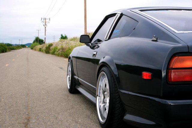

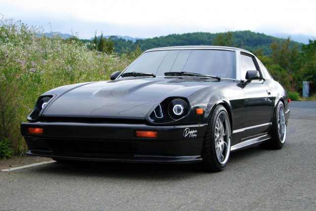

Marc280 Posted November 26, 2015 Share Posted November 26, 2015 I'm running 17x9 -13 on the front and a 245 tyre (without using coilovers). On the rear I've got 17x9.5 -19 and a 255 tyre. That did require rolling the guard lip. The rear had to be rolled pretty much flat to make sure it didn't rub. Also if you have the 'bumper strips' that run along the side of the car, the rear tyre will chew off the bit that goes into the wheel arch... There are some good pics of how these wheel look/fit in the Rota RB group buy thread. Here are a couple of pics of my car. <iframe width="480" height="360" src="http://s861.photobucket.com/user/marc280/embed/slideshow/1UZ%20280zx/Rota%20Wheels"></iframe> Quote Link to comment Share on other sites More sharing options...
