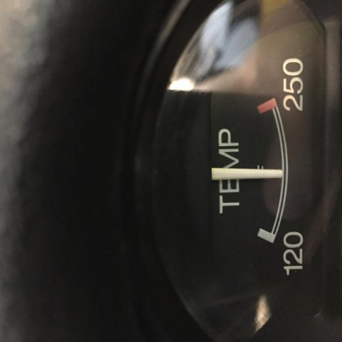

So it looks like the one i had already was the right resistance range, and my wiring was the problem. These pictures were taken at 210deg when my fan switch is supposed to come on, and at 175 when its supposed to turn off. Looks damn close to me.
Blob,
My temp level needle has more swing than your images are showing while I am sure our engines are cycling through similar temps. I am using the BMW dual fan thermostatic switch to control my cooling fans. It turns the high fan off around 200 and the low fan around 180. When you have the time you might want to try threading in the other level sensor (if you have it) to see if it will give you more resolution.
The important part is that your fans are coming on when they should be and cooling the motor. Are you able to monitor temp through the harness, via Nissan Consult or a stand alone? You can use that to ensure your fans turn on and off when advertised.
I would recommend checking to make sure that the temp level sensor will indicate when temps go too high. You want to know if your fans take a dump and you are running hot. If you dare, unplug your fans and run your engine until you see the needle go up towards the right, then just plug the fans back in or turn the car off.
