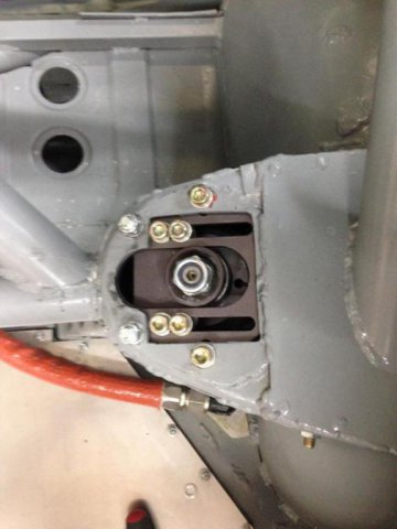

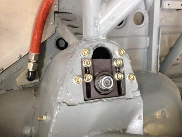

JMortensen Posted August 24, 2015 Share Posted August 24, 2015 I remember years ago John B was looking at running bias slicks and talking about flipping the GC plates around to get more positive adjustment. Due to the lowering and the control arm length change in my car, I need less neg camber than I can currently get with the plate in the normal way. It tops out at about -3.5 degrees. Flip it and I've got about -1 degree on one side and about -1.5 on the other side. The problem is that I can't move the adjuster because it immediately contacts the bolts that hold the plate in the car. Thinking I can take the top piece off and do a crude notch with my band saw and then use the closer two screw holes, but that seems to be about my only option. Am I missing anything? Quote Link to comment Share on other sites More sharing options...

JMortensen Posted August 24, 2015 Author Share Posted August 24, 2015 LCA is as short as I can get it. AZC top isn't compatible with the GC top. I could switch out the whole plate and that might be a solution, but would like to do that as a last resort. Tweak strut tube. I've heard about that forever, don't honestly know how they do it or where. Could you explain? Did make a little progress, I took the lower two bolts out and that allowed me to get to about 1.5 degrees, which I think I'll just call "close enough" for this weekend. Quote Link to comment Share on other sites More sharing options...

JMortensen Posted August 25, 2015 Author Share Posted August 25, 2015 No room for new holes. That camber plate takes up the whole space. GC suggested I buy a plate with a longer slot and cut it to fit in the strut tower, but I don't think there is room for a longer slot. Rain is closing in after what has been the hottest, driest summer I can remember since I moved here in 2002.. Looks more and more like Sat is not going to happen. Forecast said rain Sunday, then rain Saturday, now says rain Friday. Next option is in Medford, OR in 2 weeks. Really wanted to do both and get some miles on it. Would hate to tow all the way down there and then have something stupid break and have to tow back. Quote Link to comment Share on other sites More sharing options...

JMortensen Posted August 26, 2015 Author Share Posted August 26, 2015 Are you similarly limited in the range of motion when you have them "backwards"?jhm had a good idea, countersink the holes and use a flathead machine screw. Going to have a look at that, see if there is enough meat there to do it. Quote Link to comment Share on other sites More sharing options...
JMortensen Posted September 1, 2015 Author Share Posted September 1, 2015 Jhm's idea worked great, and flat head 5/16 flathead screws were easy to find at the hardware store. Only issue I had was trying to hold the screw from the bottom while tightening the nut on top. Managed to do it with an impact driver (only screwdriver I had with a big enough phillips) and a 3/8" impact gun on top. Did waste one screw trying to hold with a stubby screwdriver from the top. That didn't work at all. Also shaved the washers down as Clark suggested. If I could get away with just one screw on top then I think I'd have the full range of slot adjustment available, but not sure if running it with just one screw is a good idea. Thanks guys! Quote Link to comment Share on other sites More sharing options...
