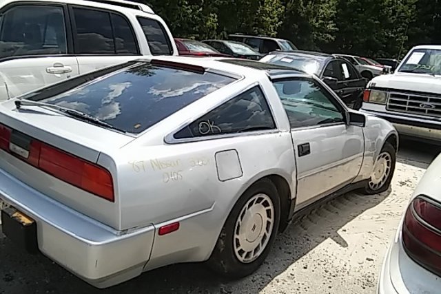

fluidmotion Posted August 26, 2015 Share Posted August 26, 2015 (edited) This car just showed up at a local yard. Is anyone able to identify if this is a turbo or NA? So far the googles has told me a NA has 15" wheels and the turbo has 16" wheels. Any other changes that could be spotted from the rear? Edited August 26, 2015 by fluidmotion Quote Link to comment Share on other sites More sharing options...
SleeperZ Posted August 26, 2015 Share Posted August 26, 2015 (edited) IIRC, all the turbo models had rear panels that screamed "TURBO!", without the exclamation point. Personally I'd dive right under and look for the finned diff cover. Edited August 26, 2015 by SleeperZ Quote Link to comment Share on other sites More sharing options...
LanceVance Posted August 26, 2015 Share Posted August 26, 2015 Personally I'd dive right under and look for the finned diff cover. This! ...or just pop the hood and look for turbos! Quote Link to comment Share on other sites More sharing options...
Nelsonian Posted August 26, 2015 Share Posted August 26, 2015 Wasn't the finned covered R200 lsd offered close to the middle months of 1987? I thought I remember reading here they did not begin at the first few months in '87. I could be very mistaken however. Quote Link to comment Share on other sites More sharing options...
fluidmotion Posted August 26, 2015 Author Share Posted August 26, 2015 Thanks for the tips. So, without the Turbo badge this car is probably a NA. The junkyard is 2 hours away so I'm going to leave this one be. Thanks again for the help. Quote Link to comment Share on other sites More sharing options...
