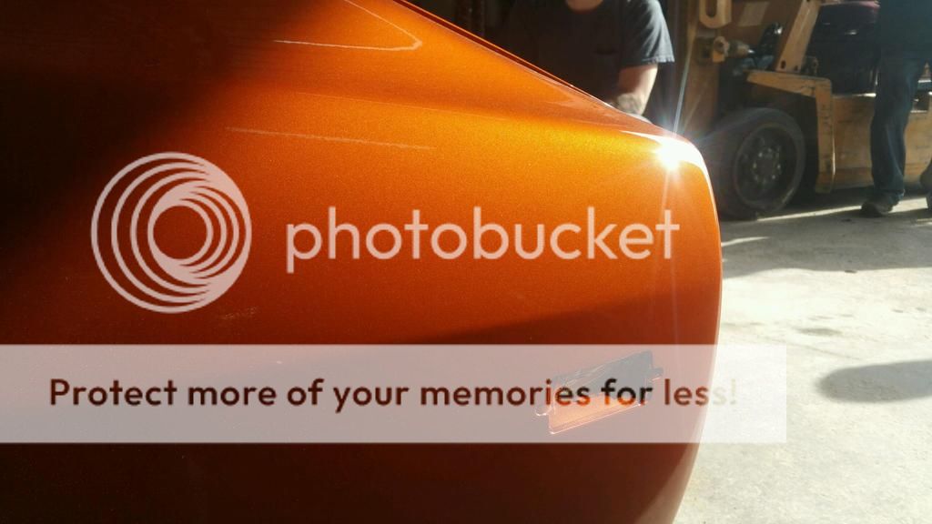

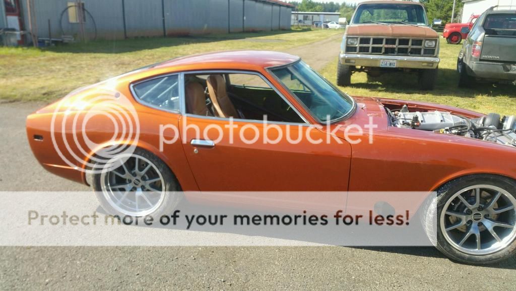

nathaninwa Posted May 28, 2016 Author Share Posted May 28, 2016 And a money shot from the sunlight Quote Link to comment Share on other sites More sharing options...

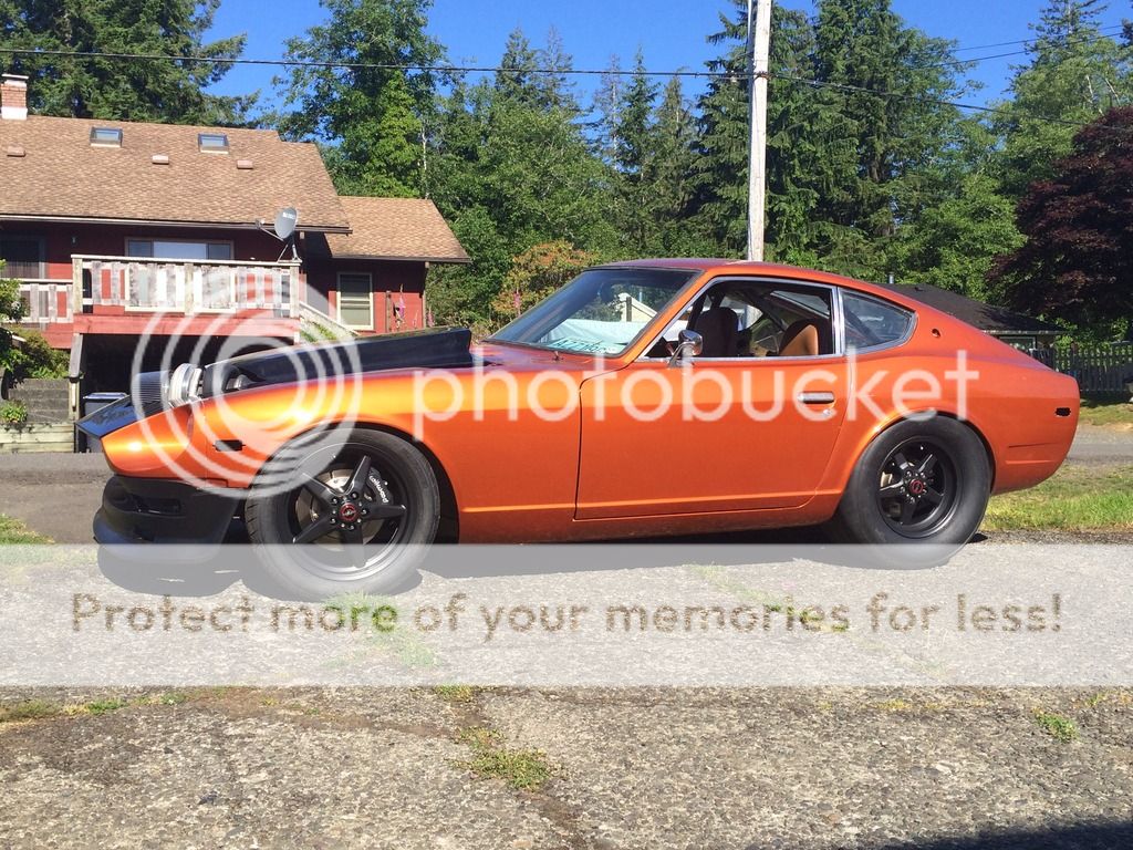

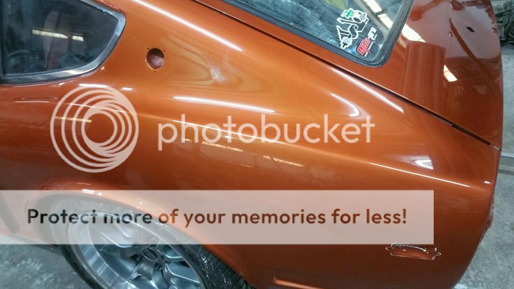

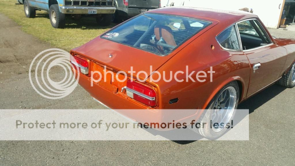

nathaninwa Posted May 29, 2016 Author Share Posted May 29, 2016 I love this rear 1/4 shot Quote Link to comment Share on other sites More sharing options...

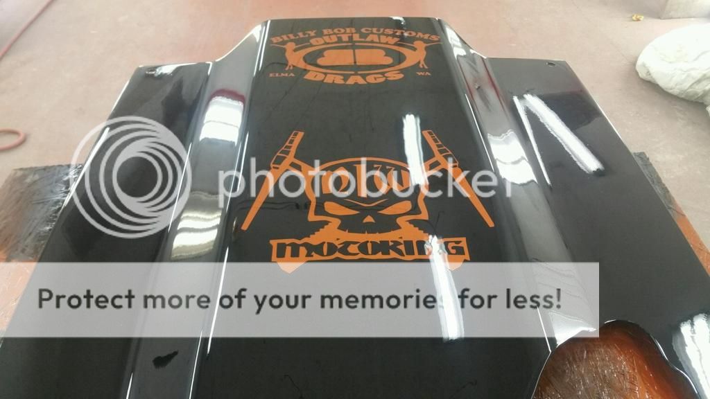

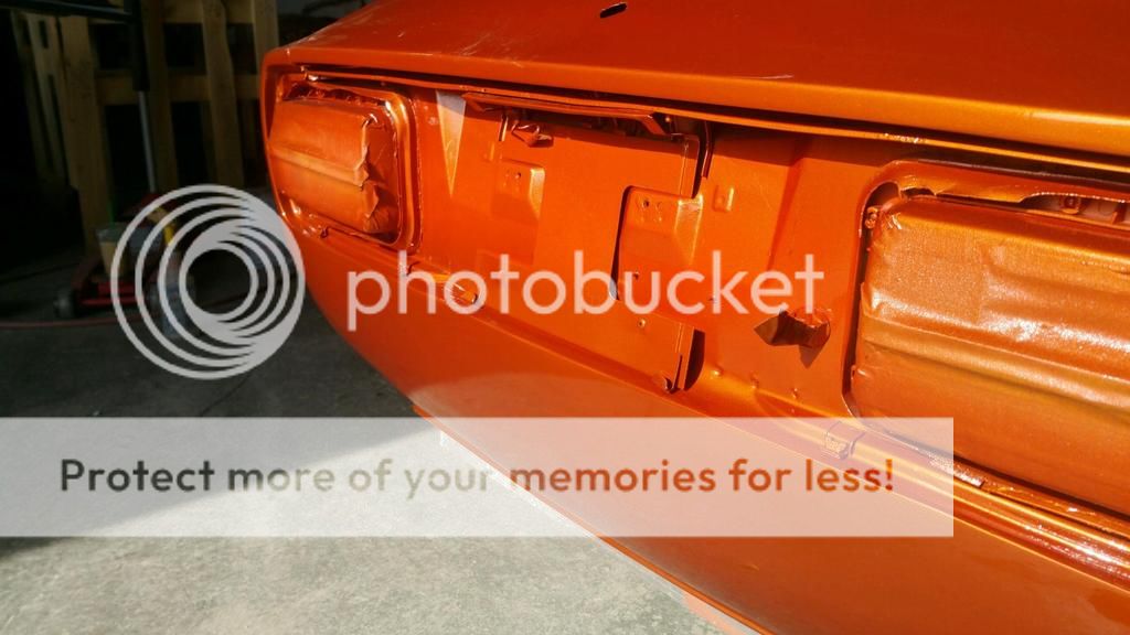

nathaninwa Posted May 29, 2016 Author Share Posted May 29, 2016 And the final PC of the puzzle Quote Link to comment Share on other sites More sharing options...

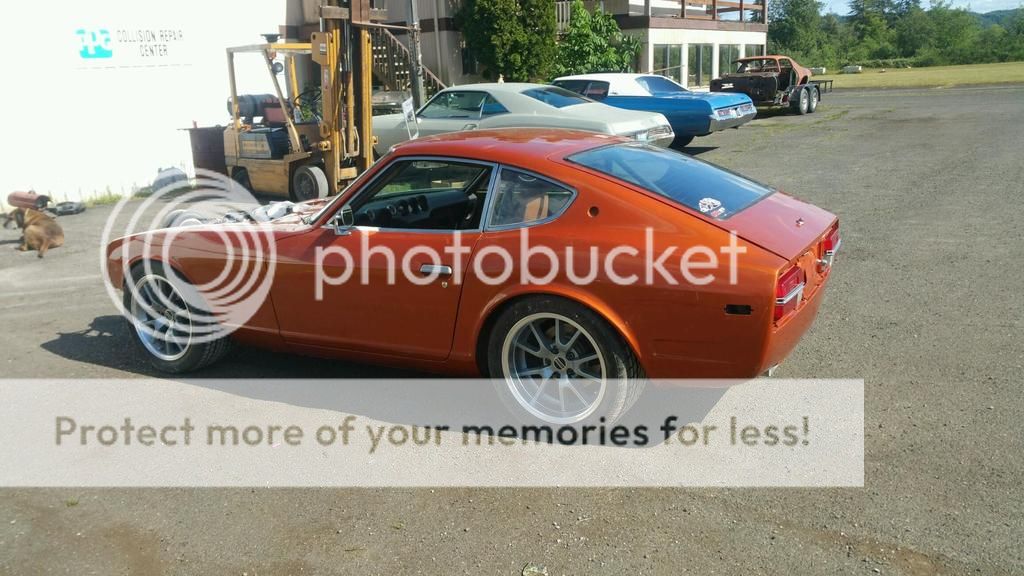

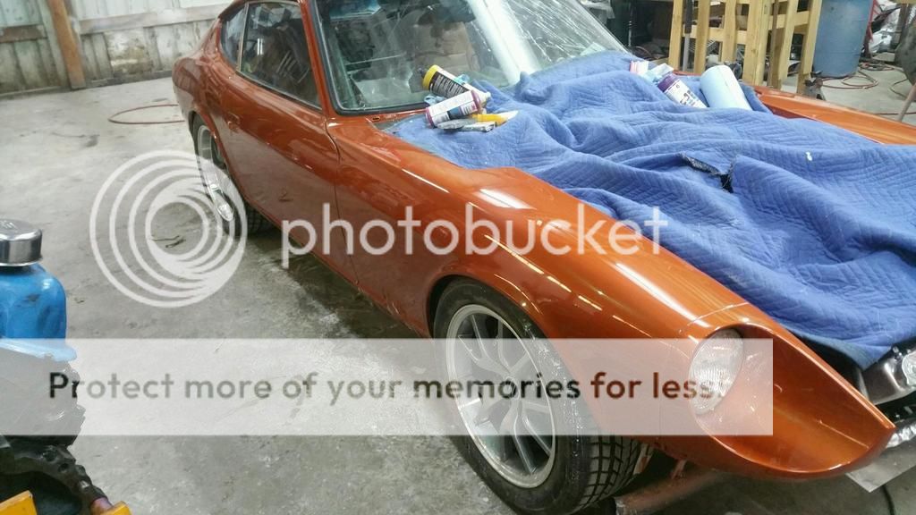

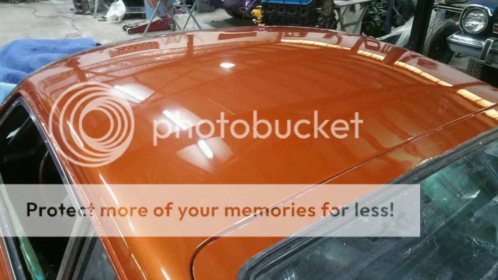

nathaninwa Posted May 30, 2016 Author Share Posted May 30, 2016 Final shots of it all sanded and buffed. I'll get it back around 1 tomorrow Quote Link to comment Share on other sites More sharing options...

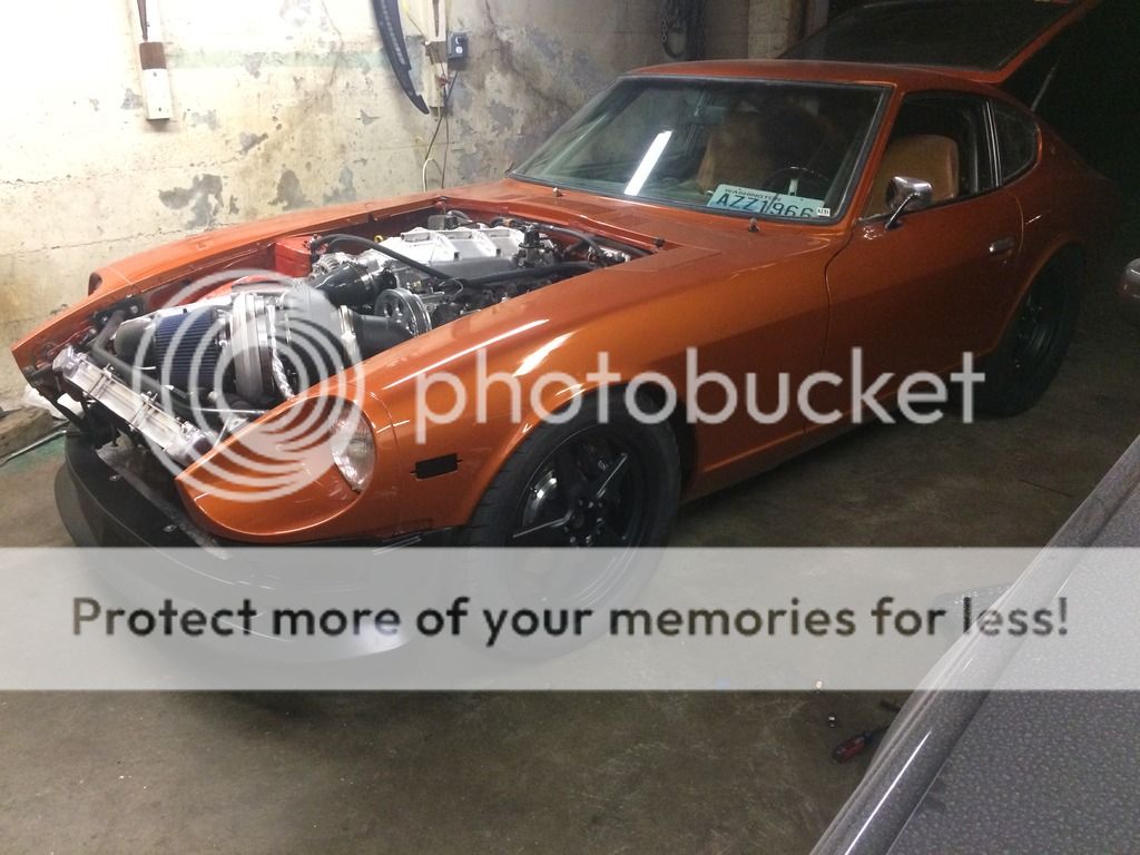

nathaninwa Posted June 5, 2016 Author Share Posted June 5, 2016 Got the water pump installed, wow what a mod if i can recommend one. Very cool to be able to run a pump and fan with the engine off Got the new gears installed yesterday too. I'll beat cycle them today Here is the car assembled minus the drag wing. Ill get to that In a few weeks. Going to shake the car down on Friday Quote Link to comment Share on other sites More sharing options...

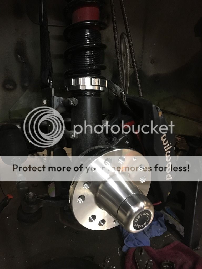

nathaninwa Posted February 4, 2017 Author Share Posted February 4, 2017 Been doing some work on this car. Updated some stuff up front, redid radiator and shroud along with moving it forward, dropping some weight too. Also updated to the borg warner race cover on the turbo Got a kirkey seat installed, saved a bunch of weight there and moved me down about 5 inches Working on a new alum dash setup and wiring up the efi a little tidier with all the add ons I did over last season Powerglide parts are on the way And what I'm excited about. Doing some googling I read on Hybridz that gm hubs will bolt onto the s30 spindle. After looking at a PDF of all the hubs, I chose the mid 80's G body hub. Replacing the 300z hub i setup everything around this hub is almost a drop in with rotor placement 1/8 closer and the wheel moving in 1/16. The 3rd gen Camaro would put the rotor in the same location for me but move the wheel out 1/16. Some minor matching of my own rotor hat and wheel spacer can solve this but over happy with the bolt on rotor and wilwood stocks a seal that fits the spindle too The rotor no longer bolts to the back as it does on the 300z setup, rather its sandwiched between the wheel and hub. Getting the correct the rotor fitment means a 3/4 wheel spacer for me to keep the 300z wheel mounting surface location. I'll use 3 inch studs to make all this happen as one unit Quote Link to comment Share on other sites More sharing options...
