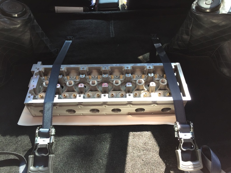

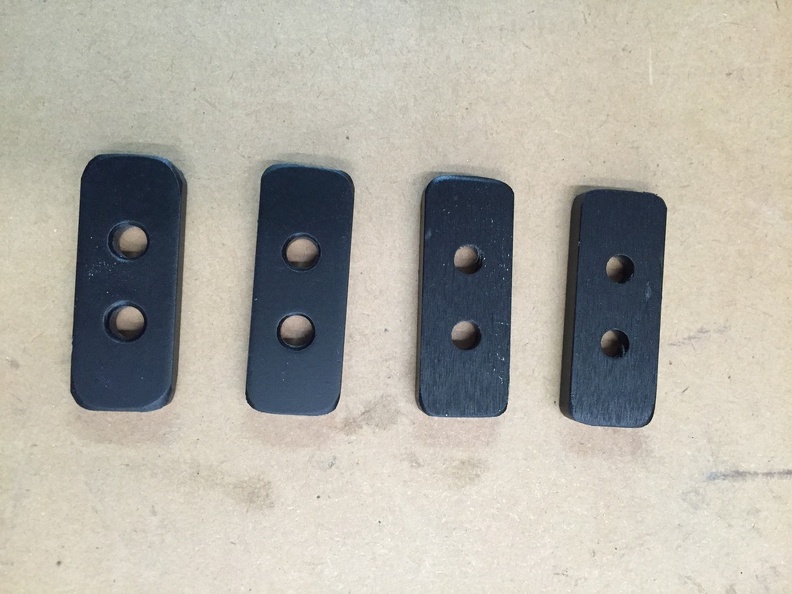

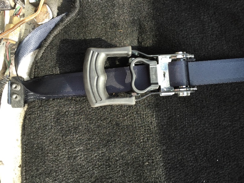

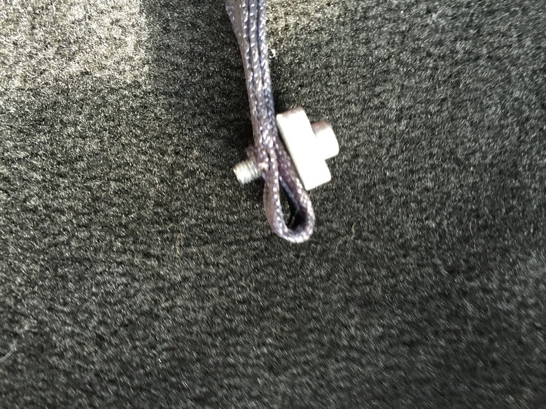

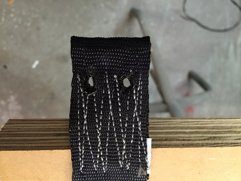

Derek Posted October 10, 2015 Share Posted October 10, 2015 (edited) I've been wanting to do this for years. I finally got around to it. Finished product: They were a little bigger that I would have liked but they were black. I got them at Harbor Freight. Made brackets out of aluminum and painted them black. I guess I could have dusted them off:) I cut the hooks out of the webbing. I cut the hooks themselves as I have an iron worker that will do that kind of thing. I left the loops in the webbing. I then used a soldering iron to burn holes through the strap. If you really wanted to get crazy you could slip a pin through the loop to keep it from pulling out but I really don't think you need it. Perfect for hauling around your twin cam L6 prototype head:) Edited July 8, 2017 by Derek Quote Link to comment Share on other sites More sharing options...
