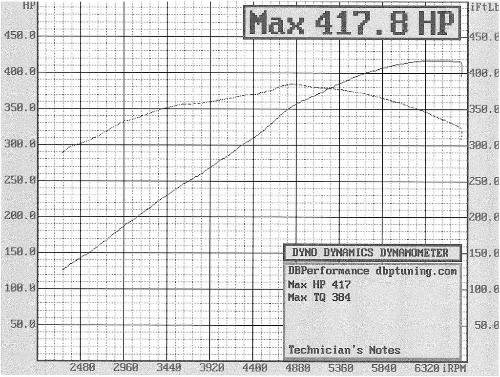

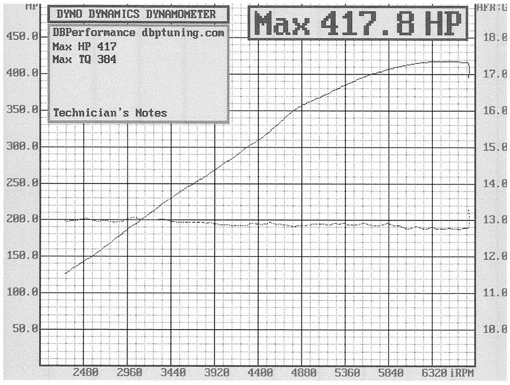

Stock Car Mafia Posted July 18, 2016 Author Share Posted July 18, 2016 (edited) The dyno session was on Monday. We got on at about 1:15 pm and it didn't take long for Shane to have the car dialed in. It took him longer to delete all the emissions CEL's than anything. bramagedained showed up with his uncle so we we able to bullshit while they worked on the car. It's always nice to see two of them side by side. Overall I am happy with the tune. The car actually idles now and no more limp mode! Shane said the GTO computer is limited as far as access for air maping at idle compared to the Corvette computer. The car still surges once or twice when decelerating. Here is one of the pulls on the dyno: https://youtu.be/xVBwF6G-l7s Edited July 18, 2016 by Stock Car Mafia Quote Link to comment Share on other sites More sharing options...

Stock Car Mafia Posted July 19, 2016 Author Share Posted July 19, 2016 Thanks man. It is a damn blast for sure! Now I'm back to the drawing board to see where to go next. I don't think I'm done modding and will push painting back a little more. This car is too much fun! I failed to mention this was done on a Dyno Dynamics dyno. It sounds like these are pretty comparable to Dynojets. But I'm not all too concerned about numbers it sure feels good behind the steering wheel. Quote Link to comment Share on other sites More sharing options...
bramagedained Posted July 19, 2016 Share Posted July 19, 2016 Im still surprised you say that it isn't that loud inside. It was really loud on the dyno. It made me a lot more curious to see what my car actually makes. It was fun hanging out, too bad the weather took a dive towards the afternoon. Quote Link to comment Share on other sites More sharing options...
RebekahsZ Posted July 19, 2016 Share Posted July 19, 2016 Looks great! When can we race? LS2 vs LS2. That would be a blast. It's interesting how our Dyno numbers differ. I guess all these machines are just approximate and depend on DA like everything else. IIRC, mine made 400hp at like 5600 and 435 tq at 4150. It would be fun to see how that worked out at the track. Let's do the Arkansas Mile next June or try to make the ZCON 2017. Maybe my POS won't be broken. Quote Link to comment Share on other sites More sharing options...
Stock Car Mafia Posted July 19, 2016 Author Share Posted July 19, 2016 I believe I am just deaf sir. But in all honesty, hearing it outside the car for the first time on the dyno....ya it is pretty damn loud. Overall I think we got lucky on the weather. It was good to see your car again. Hopefully your trip out east was a blast. Im still surprised you say that it isn't that loud inside. It was really loud on the dyno. It made me a lot more curious to see what my car actually makes. It was fun hanging out, too bad the weather took a dive towards the afternoon. Quote Link to comment Share on other sites More sharing options...
Stock Car Mafia Posted July 19, 2016 Author Share Posted July 19, 2016 I remember you saying you don't remember what dyno you were on. I am very interested in how you got your torque curve that fricken low! I've seen most N/A LS motors are around 4800 rpm. What exactly did you build or do for your intake manifold? I am wondering if that lets the motor breathe more in comparison to the absolute crap LS2 intake. I know the 243 heads breathe pretty good stock. I need to re-read your build thread and see what I can dig up. Looks great! When can we race? LS2 vs LS2. That would be a blast. It's interesting how our Dyno numbers differ. I guess all these machines are just approximate and depend on DA like everything else. IIRC, mine made 400hp at like 5600 and 435 tq at 4150. It would be fun to see how that worked out at the track. Let's do the Arkansas Mile next June or try to make the ZCON 2017. Maybe my POS won't be broken. Quote Link to comment Share on other sites More sharing options...

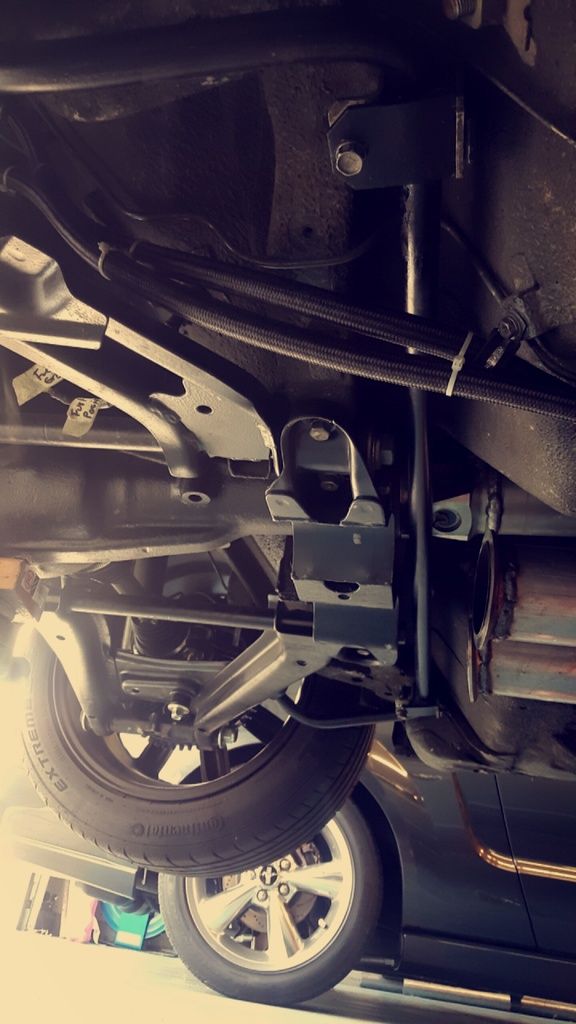

Stock Car Mafia Posted July 22, 2016 Author Share Posted July 22, 2016 I don't know what tempted me to work in the 120 deg. heat index today but I put in a couple hours in the garage tonight. Jesus even sitting still sweat rolls down your face. I went ahead and dropped the exhaust to get to the rear sway bar mounts. It turns out after all of those heat cycles on the pipes, the nuts had loosened a bit. I figured this would happen but I guess I was being lazy. Again I struggled with compressing the end links enough to get the nuts started. I had the control arm jacked up and a ratchet strap to get them started. The exhaust clears just fine. The driveshaft rear knuckle didn't....I would rub about 1/8" on 2 of the 4 corners. I know this probably changes the balance a little bit but I ground down the material on all 4 corners. It is not in a spot where I was removing strength just tabs that hang off. I didn't take any good pics as it was getting dark. Holy moses does the car feel better while cornering! The backend feels more stable and evened both sides out instead of both being independant. I love it. Now I might look into thicker bars down the road but don't want to get too off balance. A couple nights ago I got a decent shot while cruising some back roads... Quote Link to comment Share on other sites More sharing options...
