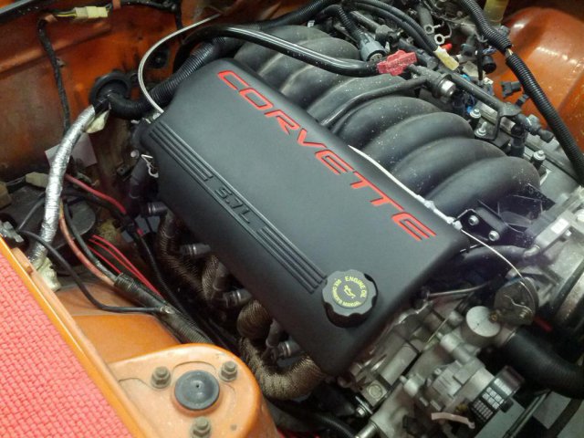

Mikey303LSZ Posted December 3, 2015 Share Posted December 3, 2015 I have John's Car (JCI) headers with an LS in a 240z. They fit great and have never burned a wire. I wrapped them and would do it again but even with no wrap there's pleanty of clearance between the OEM LS plug wires, starter etc. so I doubt there would be an issue. I highly recommend JCI headers and supporting a great guy like John. On the other hand, if you're trying to squeeze every ounce of power from the engine, perhaps add more torque or trying to match headers to non-JCI mounts then all bets are off. Quote Link to comment Share on other sites More sharing options...

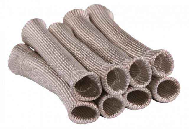

Mike Mileski Posted December 3, 2015 Share Posted December 3, 2015 I have some high temp sleeving similar to this on my wires and I've never had any issues, and we're talking AZ in the summertime. Mike Mileski Tucson, AZ Quote Link to comment Share on other sites More sharing options...

ktm Posted December 7, 2015 Share Posted December 7, 2015 (edited) On 12/4/2015 at 4:05 AM, blu240z said: Where did you get the sleeving from ? DEI makes the heat socks. Just Google "DEI plug wire socks". I was torn between JCI an JTR, but opted for the JTR primarily due to the larger primaries. I was going to buy a header and did not want to limit myself at the time. Now that I've found a solution with the heat shields, I am happy I went with the JTR (Sanderson) headers, but if I were to do it again knowing where I am today, I probably would have gone with the JCI. I also would change out the damn exhaust flange for a V-band or ball setup. Changing those damn gaskets majorly sucks. Edited December 7, 2015 by ktm Quote Link to comment Share on other sites More sharing options...
