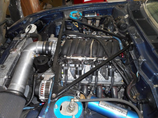

260DET Posted March 23, 2016 Share Posted March 23, 2016 (edited) On the 280ZX which used to handle great but now on the same cold semi slicks has lost nearly all grip on turn in after fitting a triangular brace from strut top to strut top and back to the reinforced center of the horizontal firewall seam. The difference, with nothing else changed, is spectacular. It was a circuit track test day for the auto so we were concentrating on other things but it was like driving on ice at the front, with cold tyres anyway. Everything is adjustable on this Z, including rebound and low and high speed bump. Any suggestions where I should start? Edited March 23, 2016 by 260DET Quote Link to comment Share on other sites More sharing options...

260DET Posted April 13, 2016 Author Share Posted April 13, 2016 Softened the front ARB up a bit, not a lot, and the understeer is gone. In fact it's a bit oversteery now so some of the ARB change will be reversed. It certainly happens that once the body is stiffened up small suspension changes can make a big difference. Quote Link to comment Share on other sites More sharing options...
260DET Posted April 15, 2016 Author Share Posted April 15, 2016 Routine check showed that the four M8 brace bolts to the firewall had loosened up quite a bit after some track work, obviously there is body movement between there and the area forward of the firewall. I just hope that tightening them does not result in another handling change. Quote Link to comment Share on other sites More sharing options...
260DET Posted April 16, 2016 Author Share Posted April 16, 2016 Pic of said engine brace. Quote Link to comment Share on other sites More sharing options...
