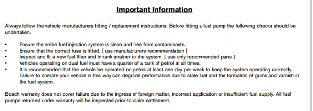

Chickenman Posted June 28, 2016 Share Posted June 28, 2016 (edited) Installation instructions from Bosch. Note references to cleaning COMPLETE fuel system including fuel tanks. And replacing all in tank strainers Direct link to Bosch .PDF. https://www.google.ca/url?sa=t&rct=j&q=&esrc=s&source=web&cd=10&ved=0ahUKEwi9zIPN5MvNAhUJxGMKHcTpBF4QFghXMAk&url=http%3A%2F%2Fwww.outlawspeed.com.au%2Fsendfile.php%2Fid%2F1bd79dc5646b0592221c3442af7d99df%2Fname%2FWheelBackSpace.pdf&usg=AFQjCNH_AYnAqkOrUSO1Ky8XLkr32xPNRw&sig2=fArAq4pvZUmZeUqgNTFgGA&cad=rja Important InformationAlways follow the vehicle manufacturers fitting / replacement instructions. Before fitting a fuel pump the following checks should be undertaken.• Ensure the entire fuel injection system is clean and free from contaminants.• Ensure that the correct fuse is fitted. [ use manufacturers recommendation ]• Inspect and fit a new fuel filter and in-tank strainer to the system. [ use only recommended parts ]• Vehicles operating on dual fuel must have a quarter of a tank of petrol at all times.• It is recommended that the vehicle be operated on petrol at least one day per week to keep the system operating correctly. Failure to operate your vehicle in this way can degrade performance due to stale fuel and the formation of gums and varnish in the fuel system.Bosch warranty does not cover failure due to the ingress of foreign matter, incorrect application or insufficient fuel supply. All fuel pumps returned under warranty will be inspected prior to claim settlement. Before fitting new pumpBefore fitting a replacement 12v fuel pump, please investigate the reason for the failure of the existing pump and rectify as neccessary. Check the current draw of the fuel pump which should be less than 6.5 amps for EFI systems; for K and KE Jetronic systems 11 amps. Excessive current draw or noisy operation can indicate foreign material in the pump roller cell. Use only a fuse having the correctrating as specified by the vehicle manufacturer. After removing the old pump from the vehicle, empty the contents of the pump into a container. Examine the fuel for signs of foreignmaterial including rust, rubber, varnish, plastic etc. The complete system should be inspected and cleaned if neccessary; this includes the fuel tank, fuel rail, pressure regulator, tank pickup unit and strainer. When refitting the hoses to the pump and fuel filter, take care not to damage the hoses as small rubber particles can circulate through the system and become jammed in the fuel pump, regulator or injector. Fit new fuel pump, check the current draw, check fuel rail pressure. Bosch warranty does not cover failure that results from the ingress of foreign matter; incorrect application or damage resulting from pumps operating with insufficient fuel in the tank as in LPG conversions. Edited June 28, 2016 by Chickenman Quote Link to comment Share on other sites More sharing options...

NewZed Posted June 28, 2016 Share Posted June 28, 2016 Installation instructions from Bosch. Note referalls to cleaning COMPLETE fuel system including fuel tanks. And replacing all in tank strainers Direct link to Bosch .PDF. https://www.google.ca/url?sa=t&rct=j&q=&esrc=s&source=web&cd=10&ved=0ahUKEwi9zIPN5MvNAhUJxGMKHcTpBF4QFghXMAk&url=http%3A%2F%2Fwww.outlawspeed.com.au%2Fsendfile.php%2Fid%2F1bd79dc5646b0592221c3442af7d99df%2Fname%2FWheelBackSpace.pdf&usg=AFQjCNH_AYnAqkOrUSO1Ky8XLkr32xPNRw&sig2=fArAq4pvZUmZeUqgNTFgGA&cad=rja That's something. No demands though, just the boilerplate "warranty will be voided" copy. Quite a difference between a strainer and filter. You'd think more is better, but it's not. Quote Link to comment Share on other sites More sharing options...
Chickenman Posted June 28, 2016 Share Posted June 28, 2016 You're avoiding the points and you've edited your original post. No point in talking to someone who revises history and won't own what they said. I didn't say Airtex was small, I said that they were just a run-of-the-mill aftermarket supplier. Not some high performance ceramic turbine technology (whatever that is) race pump producer. And my points about using what the big manufacturers use is valid and logical. They did the research. And they don't use prefilters. I edit my post for Spelling errors. All the time. I don't like bad spelling. I also add links with my edits. Don't try and make out that I'm trying to change content with my edits. And OEM manufactures certainly do use pre-filters ( Mesh screens or Socks ) for the in tank fuel pumps. . They're on Fords. Chevies, Honda' Nissan, BMW, Porsches, Audi, VW's and every car you buy off a show room floor. Have been since the 1980's. That's a fact and cannot be disputed. Period. Quote Link to comment Share on other sites More sharing options...
