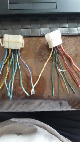

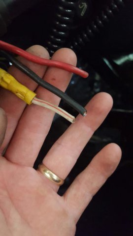

stony Posted July 30, 2016 Share Posted July 30, 2016 I have a set of toggle switches wired in now for headlights and turn signals. I want to wire those into the stock combo switch. Need to know what wires go where. 3 stand alone large gauge wires. I THINK I HAVE THESE RIGHT BUT LET ME KNOW IF THEY ARE WRONG 1. R = BATTERY POWER 2. B = GROUND 3. WR = SWITCH 12V 6 pin plug 1. RW = 2. RB = 3. GR = 4. w = 5. GB x 2 = 9 pin plug 1. GW = 2. GL = 3. LY = 4. YL = 5. L = 6. LW = 7. YB = 8. LY = 9. LR = Quote Link to comment Share on other sites More sharing options...

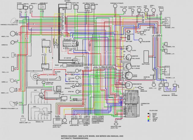

Miles Posted July 30, 2016 Share Posted July 30, 2016 (edited) Google this: "240z electrical schematic" Many Z owners have made color electrical schematics. Also: "240Z combination switch repair" Many how-to repair/wire combo switch write ups by Z owners. Some have all of the wires to the combo switch identified by color and function. See attached example. Edited July 30, 2016 by Miles Quote Link to comment Share on other sites More sharing options...
stony Posted July 31, 2016 Author Share Posted July 31, 2016 I don't have any of the stock harness and those diagrams aren't much help with my limited expeirence reading those. Would be awesome if someone could tell me which of the wires I use and where they go. Especially the 3 larger gauge wires. Quote Link to comment Share on other sites More sharing options...

Exposed Posted November 17, 2016 Share Posted November 17, 2016 (edited) hopefully someone can shed some light on this. the wiring diagram in post #2 shows the hazard switch have the following colours GW,GR,GB,G,G,GY,GY,WB,WR But when looking at the hazard switch i see red,green, white, yellow, black, red/white, red/yellow, red/black and red/blue Can someone explain what im missing, why dont the colours match up? Edited November 18, 2016 by Exposed Quote Link to comment Share on other sites More sharing options...
