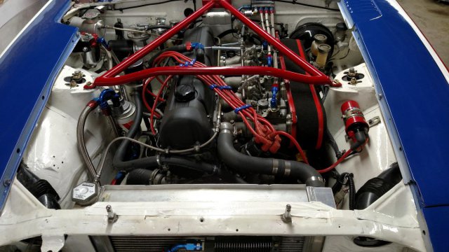

The rather expensive vacuum pump I had in my street 240 has been moved over to the 240 race car. The street car has just a vacuum canister now while the race car with a CR of 13.7:1 is in need of a bit more vacuum. It is mounted on the battery stand with the relay just above it to the left.
Works fine but is loud. How loud? Loud enough to be heard in a completely stripped out interior with twin trumpets, no mufflers, custom ear plugs and a helmet..
