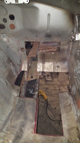

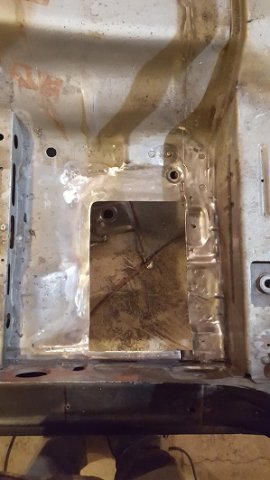

  Before we wrapped the rear floor up I had to address the beat rails and get them situated. Part of the floors got cut out above the rails so I could gain access, I welded a 1/2' bolt to some small pieces of 1/8" flat plate and tacked these to the rail. Then used my slide hammer and 1/2" all thread and a coupler, heated the rail up with the torch and pulled out most of it. What we couldn't get with the slide hammer we used a piece of 3/8 x 3" flat plate and beat them out with the 5lb hammer, it sucked. Next I bent up all the sheaths for the rail, opted to do this instead of cut them out so it preserved the structural integrity of the sub frame. Pictures are self explanatory. I included the measurements so if anybody wants to do this it's there. It took me a dozen tries to get the right measurements, so your welcome. There's some pictures of the rear floor, everything is tied in and back in place, we still have a couple spots to weld it in solid, just waiting on my buddy to get freed up so we can finish buttoning it up.

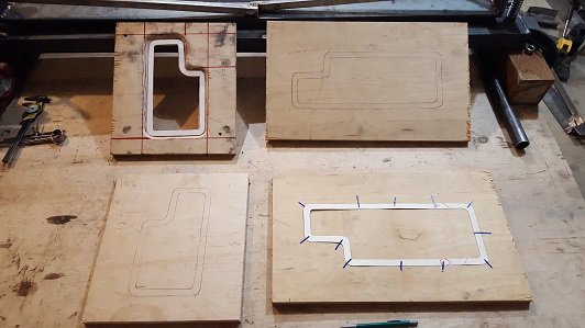

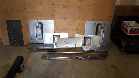

Onto the floors, also a PITA. I made forms out of 3/4" ply, cut them out and routed them. then I screwed them to another piece of ply, clamped them down and using a torch periodically hand pounded them out. If I had a bearing press it would have made the job so much easier, but it was worth the experience I suppose. Regardless The floors are now back in and welded solid, probably way more sturdy than the original OEM stuff. We doubled up over the rear sub frame mounts with 18ga and then I got grade 8 bolts and welded those to some 1/8" flat plate which will get welded to the floor. Onto paint.
