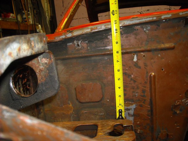

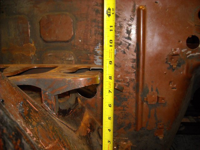

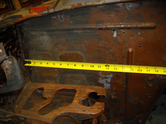

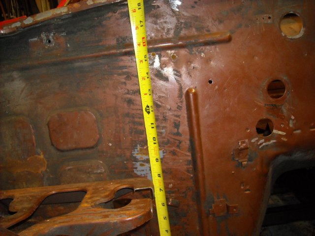

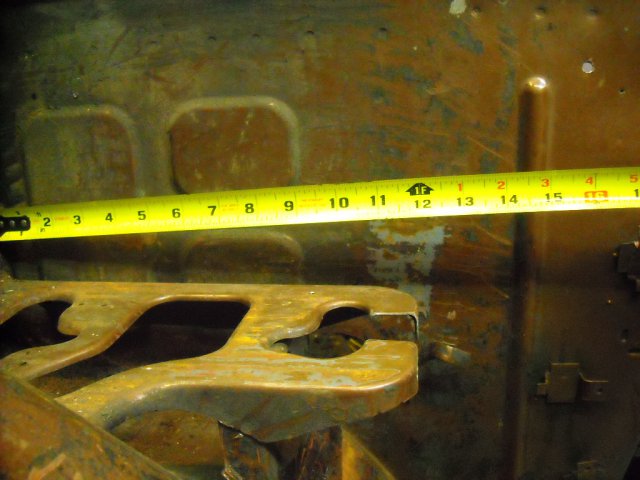

LLave Posted February 7, 2017 Share Posted February 7, 2017 I am hoping someone can take a few measurements for me. I need to repair the battery tray area of my firewall and inner fender. But the sheemetal has already (poorly) been replaced and I have nothing to reference to. Can someone give me the dimensions of the square/rectangular features that are on the firewall? And their distance from the horizontal and vertical round beads? I want to get it close to factory. Also, the height of the tray and wheel well from the frame, or the top of the firewall. Thanks! Quote Link to comment Share on other sites More sharing options...

LLave Posted February 8, 2017 Author Share Posted February 8, 2017 What year is your Z. I have a '75 currently with a stripped engine bay but it might be different than yours. Daniel If you can snag a few measurements or take a couple of pics with a tape measure in it, that would be awesome! Quote Link to comment Share on other sites More sharing options...
grannyknot Posted February 8, 2017 Share Posted February 8, 2017 Hopefully these will help, sorry they are crooked but I was clicking the camera with my left hand, Quote Link to comment Share on other sites More sharing options...
