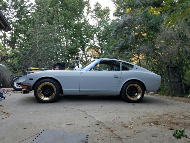

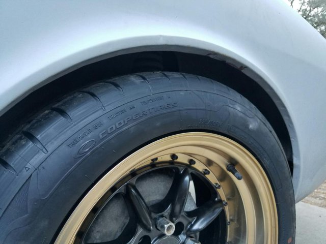

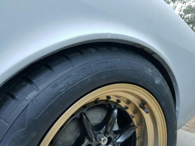

ScramblerX Posted March 13, 2017 Author Share Posted March 13, 2017 So i ended up getting a XXR 002.5. I tried to get them in Matte black but the were out of stock. The local tire place brought in the bronze lip ones instead. They definitly are not my first choice but they are temporary until i get my fender flares going so i picked them up. Plus they were cheap at 350 for the set. Wheels - XXR 002.5, 16x8 - offset 0 Tires - 225/50/R16 Cooper Zeon RS3. I mounted them up, everything looked good, went for a quick spin around the block and all 4 tires are rubbing when i hit a bump. The suspension is stock, as far as i know original and could be saging so that my be my best bet. I want to go with Ground Control coils and TBD strut but cheaper at the moment is better as I am way out of budget. Do you think a suspension refresh will get rid of the rubbing or should i be rolling the fenders? of course, some pictures. Unloaded gap on rear: Loaded with me sitting in the car - full fledged american at 240lbs =D Quote Link to comment Share on other sites More sharing options...
trackzpeed Posted March 16, 2017 Share Posted March 16, 2017 Try rolling the fenders. That worked for me...... You can also use chevette springs and cut them down. They are much stiffer and will keep your car from sagging out so much. Quote Link to comment Share on other sites More sharing options...

Neverdone Posted March 16, 2017 Share Posted March 16, 2017 Anything stopping you from just cutting the fender and installing flares that you said you were going to do anyway? Quote Link to comment Share on other sites More sharing options...

Neverdone Posted March 16, 2017 Share Posted March 16, 2017 I think you should really answer the question: Do I want flares on my car? Before you do anything. Because if that's what you wanna do, then do that. You can get wheel spacers for 50 bucks if the slight gap is bugging you and you don't feel like getting new wheels again (of course right now your wheels are practically new and have no curb rash and would be easier to clear to re-sell...) If you're not going to flare the car, then I'd look into rolling your fender a bit and more than likely getting new springs...or losing 140 lbs. Quote Link to comment Share on other sites More sharing options...
