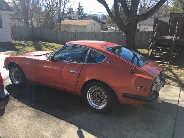

theczechone Posted March 30, 2017 Share Posted March 30, 2017 So i've looked through like 30 pages of post your wheels thread and can't find the right picture. I would like to get new tires for my 240z, I have a set of 15x8 ROTA rkr with 0 offset. I would like a set of Hankook RS4 but they are only available in 225/45/15. I'm not sure how that's going to look on the 240z. I don't want a big gap between the fender and tire. Can someone post a picture of 225/45/15s on an 8 inch rim? Please also mention any modification to the suspension. Thanks Quote Link to comment Share on other sites More sharing options...

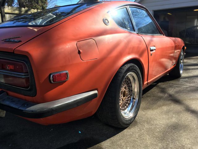

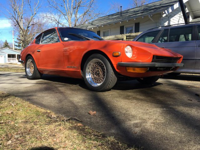

seattlejester Posted March 30, 2017 Share Posted March 30, 2017 Rim width doesn't really matter for determining the gap between the fender and tire unless you are referring to being really low. A picture on your part may be helpful to determine what you consider acceptable. A 225/45/15 is a pretty small tire. I had the BFG Rival S and they were really small in diameter. 23 inches if I remember, the stock tire size is around 25. The 225/50/15 is 24 inches which I think is a nice middle ground and looks good. Car with 225/45/15 on a 15x7+0. After this picture I had to drive it back in and adjust the height because it was scraping the floor. Quote Link to comment Share on other sites More sharing options...

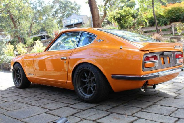

theczechone Posted April 3, 2017 Author Share Posted April 3, 2017 Big fan of this car, I think those are 225/50 kumho tires on the rear Any other choices in 225/50/15 other than what's on tire rack? Would love to get a tire like Toyota ra1 in 225/50 Quote Link to comment Share on other sites More sharing options...

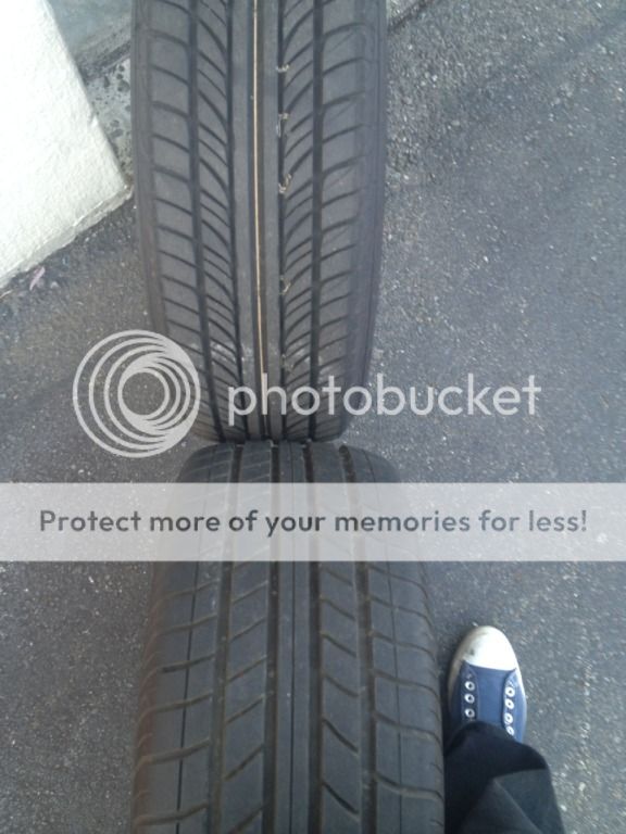

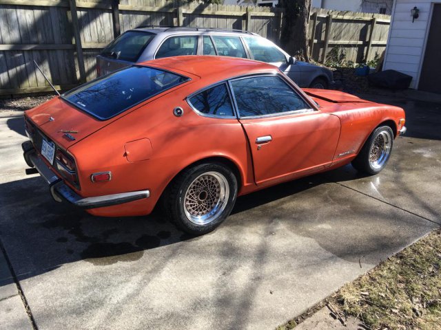

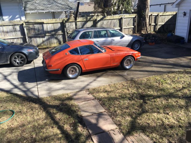

seattlejester Posted April 3, 2017 Share Posted April 3, 2017 I have a 240z and yes I am running the extreme BC coilover kit. That is unfortunately the case I think hondas and miatas run that smaller tire size so we're kind of out of luck. Here's the car with the 225/50/15 Kumho Ecstas. Compared to the 225/45/15 BF Rivals Just fills out a lot better. The factory tire size is actually even bigger then the 225/50/15, that fills out the well even better, but almost looks like too much tire at that point. Car with the 215/60/15 falken azenis They have a pretty bad contact patch though Falken on top and Kumho on bottom Quote Link to comment Share on other sites More sharing options...

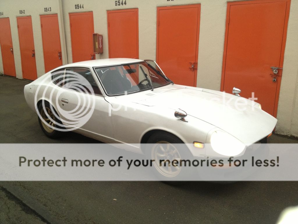

theczechone Posted April 4, 2017 Author Share Posted April 4, 2017 (edited) Here is the car in question. In the picture the car has 15x7 or 15x7.5 +5offset epsilon wheels. Rear tires are BFG G force sport 225/50/15 (NLA) and fronts are Dunlop Direzza II 205/50/15. Suspension is all stock. There is entirely too much wheel gap on the front, and the 225/45 have the same OD as the 205/50, so that basically answers my question. Also i no longer have these wheels, right now i have a set of Rota RKR 15x8 +0 offset wheels with el cheapo 215/60/15 tires. They fill out the wheel well great but the car sits like a 4x4. grr. In hindsight i should have went with 16" wheels way more tire options. Jester, thank you for posting the pictures of your car. it doesn't look bad with the 225/45 but i will definitely need to do some suspension work to change the car's altitude to make it look decent. Edited April 4, 2017 by theczechone Quote Link to comment Share on other sites More sharing options...

seattlejester Posted April 4, 2017 Share Posted April 4, 2017 To make it look decent I think you would have to drop about an inch or so more then I am at, and at that height I was high centering the floor on things. I get what you mean though the 215/60/15 make the car look like its on stilts. Probably why my set only has 1000 miles on it. I am definitely planning the move to 16's, not many more tire choices, but the extra rim diameter makes more tires look "right." Quote Link to comment Share on other sites More sharing options...
