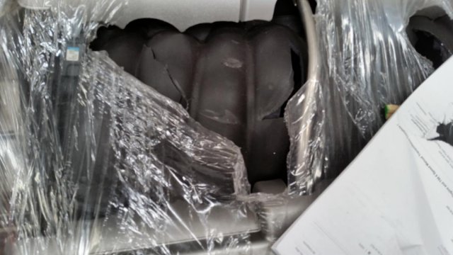

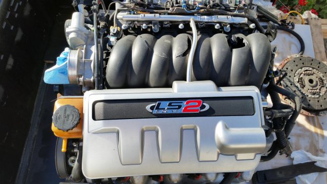

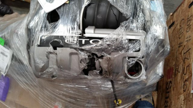

mrk3cobra Posted July 13, 2017 Author Share Posted July 13, 2017 (edited) Does anyone know if the Sanderson 1 5/8" headers on the JTR web site will work with either the Hoke or CRX kit? I have to say that Austin from Hoke has been very helpful answering email questions. To me the customer service may be worth the extra cost. I have never received an email back from CRX. They may just be to busy to answer email questions. I know these headers would not flow as well as long tube headers but I would be able to custom build the exhaust from the header back with 2.5" pipe and make sure I have the most ground clearance possible. I went to pick up my LS2 and T56 at the freight company yesterday and it looks like they dropped something heavy on the top of the engine. Waiting for the insurance company to write me a check before I accept the engine. Edited July 13, 2017 by mrk3cobra Quote Link to comment Share on other sites More sharing options...
BrandenZ Posted July 13, 2017 Share Posted July 13, 2017 (edited) I would be very surprised if they didn't, given how much bigger the Hawks headers are, which do fit. That said, you should definitely check with Austin first. He was patient and willing to help me with countless silly questions across my swap. Ugh. RIP intake manifold! The good news is, that's easy to swap out. Depending on how your fuel is setup, you may want to swap the inlet rail to the passenger side anyway. Just get them to replace it with a FAST manifold instead! For reference, here's a pic of my Hawks, reduced immediately from 3" to 2.5"... Edited July 13, 2017 by BrandenZ Quote Link to comment Share on other sites More sharing options...

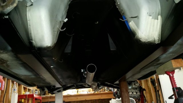

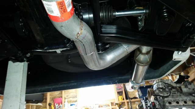

mrk3cobra Posted July 17, 2017 Author Share Posted July 17, 2017 Just finished installing my Bad dog frame rails. Ran the rear exhaust. Quote Link to comment Share on other sites More sharing options...
