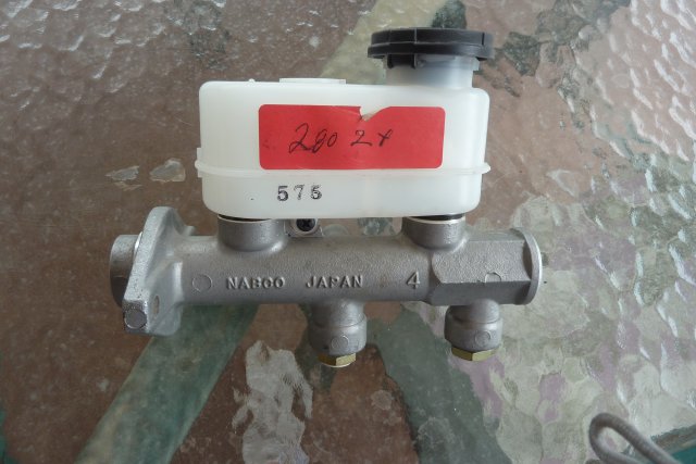

Litman Posted October 5, 2017 Share Posted October 5, 2017 I have this from my '83ZXT Quote Link to comment Share on other sites More sharing options...
Litman Posted October 5, 2017 Share Posted October 5, 2017 Just noticed your request indicates specifically 79-81. Not certain how the 82-83 varies from what you are looking for. Quote Link to comment Share on other sites More sharing options...

ScramblerX Posted October 5, 2017 Author Share Posted October 5, 2017 I have a 240Z and switching to the s12-8 Toyota calipers and the how-to mentioned the change to a 15/16 master from the years 79-81. I personally don't know what changed. Quote Link to comment Share on other sites More sharing options...

wheee! Posted October 10, 2017 Share Posted October 10, 2017 Get the one from Arizona Z Cars, it is the correct orientation of mounting bolts and is $129 with new reservoirs. perfect for what you are doing. Anything like those pictures above will require a new Brake Booster as well. This is the one you want. I ordered this one for my 76 Quote Link to comment Share on other sites More sharing options...
ScramblerX Posted October 10, 2017 Author Share Posted October 10, 2017 On 10/10/2017 at 2:07 AM, theczechone said: Bought mine from O'Reilly auto parts. Works good. Pretty sure the ports are switched though. Front is back and back is front. So make sure your lines are routed correctly. Expand Thanks for the heads up, I walked into O'Reillys and it was 40 bucks OTD, should be in store in 2 days and i'm hoping to get everything installed this weekend. On 10/10/2017 at 6:41 PM, wheee! said: Get the one from Arizona Z Cars, it is the correct orientation of mounting bolts and is $129 with new reservoirs. perfect for what you are doing. Anything like those pictures above will require a new Brake Booster as well. This is the one you want. I ordered this one for my 76 Expand That does look nice - hopefully i won't be dissappionted in the O'Reilly rebuild. Will the reservoirs from the original 240Z fit? Quote Link to comment Share on other sites More sharing options...
