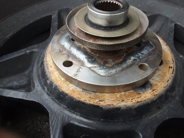

For the half shafts, I have been having a very bad vibration on the highway so one day I jacked the car up and very carefully had the wife inside while I was under it watching for the movement... The driver side half shaft jumps around like a kid on candy. To rectify this, I will be swapping in the 300zxt cv shafts. I have ordered adapter plates from cave built performance for $220. They are 1/2 in steel that have a reses machined in to allow the companion flange to sit in and be welded together. After talking to the maker, I will not be flipping the cage but I will be checking travel by removing the spring and flexing the suspension to ensure it doesn't bind.

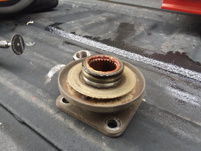

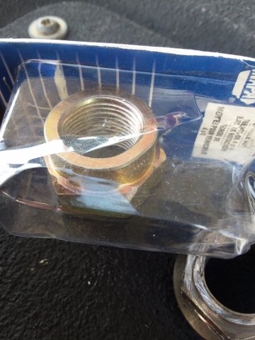

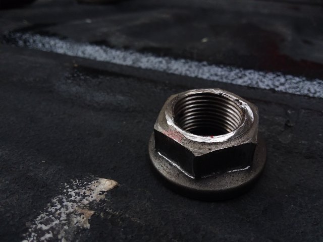

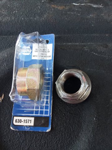

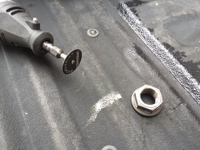

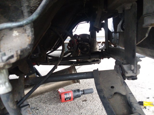

Well got everything pulled apart which wasn't as bad as I thought it would be. Took about 4 hours to get both companion flanges pulled off, and the differential dropped. Cutting the stub shaft bolt wasn't as bad as I thought, 10 min with a drimal per side while spinning the disk break to get a nice cut all around. To replace the nut, since I do not have a nissan dealer near by, I went to Napa and the parts guy went back with my 20x1.5 nut and 15min later came back with one for some 4x4 vehicle (part number in photo). After welding everything up with 7013 rods on my home made welder (yes, home made) I am 100% sure these will hold without a problem.

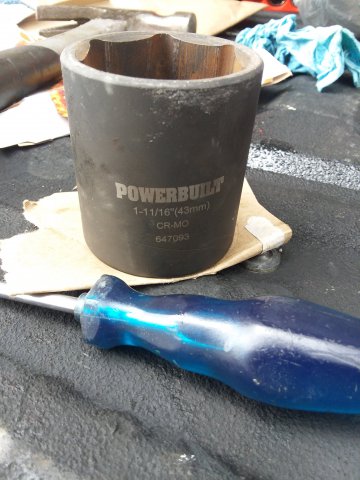

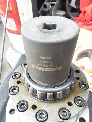

Worst part of it all was removing the carrier bearings form the old unit and then putting them on the new one. Luckly I had the perfict size socket (1-11/16) to assist with the reinstalling of the bearing.

I am still working on getting everything bolted up (work got in the way). The axles were still to long. Don't even try the rock auto, autozone axles because they won't work, they have to be the stock 300zx axle (others have talked on this). Even still they were to long and had to be shortened via someone else's idea. He only however shortened one side. I shortened both and got about 3/4 in space between the spacer and the axle giving plenty of travle.
