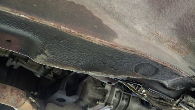

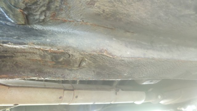

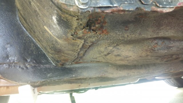

My current 280zx is very rusty, I found a shell that has much less rust. Would you consider this being low on rust?
The passenger frame rail looks the worst:
Driver floorpan has  rust
Driver side frame rail looks better:
These are the spots I could find.

Test it with a screwdriver (poke around at it) and see if it is completely rusted out structurally.  If you can mig weld , or weld in general it isn't a hard fix.
And if you dont want to patch fix it they also have complete floor boards and rails you can weld on.
