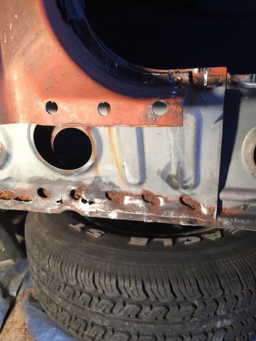

Roberts280Z Posted June 2, 2018 Share Posted June 2, 2018 I bought a Tabco rocker panel, thinking originally that I would just replace the whole thing. But now I'm thinking I'll have less work, and do a better job, if I just replace the sections that need it (sill area), using the Tabco part as donor. Thanks in advance Quote Link to comment Share on other sites More sharing options...
rturbo 930 Posted June 2, 2018 Share Posted June 2, 2018 Is that all the rust there is, just on the top? Have you checked other areas inside the rocker to see if there is other rust? If that's all there is, I would just bend up some sheet metal to patch with and sell the rocker. The top of mine is kinda wavy, really not a great piece. Quote Link to comment Share on other sites More sharing options...
Roberts280Z Posted June 3, 2018 Author Share Posted June 3, 2018 Thanks for that. Yeah, the rocker bottom looks good. If I hadn't already bought the panel, I would just make some patches like you say. I'm new to this kind of work, and sometimes the obvious isn't so obvious to me. Quote Link to comment Share on other sites More sharing options...

Roberts280Z Posted October 19, 2018 Author Share Posted October 19, 2018 Thanks for the interest, Jughead. This is where I am now. I cut out the green-outlined section from the Tabco rocker and welded in. I fabricated the blue-outlined 'armpit' section and welded in. Then I covered the rear, pink-outlined, section with the lower part of a Tabco patch panel. I've spent the last few weeks on another car, but will come back to this after I get another bottle of shielding gas. I've still got the door bottoms and tailgate bottom to do, plus join up the floor bottom frame rails to the remaining front frame rails. Quote Link to comment Share on other sites More sharing options...

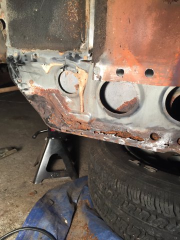

Jughead Posted February 15, 2019 Share Posted February 15, 2019 @Roberts280z: Here's what I found when I removed mine. You see alot like this, and more a lot worse. Suggestion: Buy an Endoscope. They're about $35 on Amazon. You can feed it through the inside. It will light up the insife and lt you see everything. It might help you decide upon your strategy. I'm few steps ahead of you. I'm almost done with the repairs and have trial fit the panels a few times. Keep me posted and I'll do the same. I've taken lots of pics which might be helpful to you. Let me know what you need to see. Quote Link to comment Share on other sites More sharing options...
Roberts280Z Posted February 15, 2019 Author Share Posted February 15, 2019 Fortunately, mine wasn't nearly that bad. Yours looks a lot like the photos from tim.d, mentioned in his earlier post. I've moved on to my doors and liftgate, which are rusted in their lower areas. I'll be starting another thread concerning how best to fix the rusted lip surrounding the liftgate opening. Quote Link to comment Share on other sites More sharing options...
