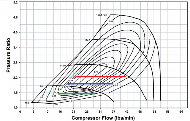

I am thinking of getting a EFR turbo for my turbo race car build. They have inbuilt BOV, wastegate and selonid so perfect for DIYers with limited fabrication capabilites. Downside its very expnsive, but the 7064 is now on sale everywhere. I guess its being replaced for something more modern.
I dont think its perfect for a 300-400hp L28 build, it seems to favor smaller displacement with higher boost.
I plotted the airflow for 10psi, 16psi and 20psi. VE is 0.8, plotted line is from 3250 RPM to 6500 RPM.
This is the same operating points on a old school T3/T4 hybrid. (from http://www.atlanticz.ca/zclub/techtips/turbo/turbomaps/index.htm)
How would the EFR 7064 compare against the older turbo plotted above? Seems it would perform similar on mid RPM but close to redline it would perform worse?
Spool is probably much faster on the EFR but efficiency seems to be equal or worse (for those operating points).
Comments? thoughts?
