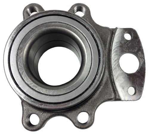

socorob Posted July 6, 2018 Share Posted July 6, 2018 I have the TTT Q45 setup on my car, and I used the rear wheel hubs with bearings that I got from the car I pulled the rear setup out of. The car had 130000ish miles on it. I want to put new bearings on when I change my spring rate soon. There are left and right versions of these. Some I found don't specify if they are right or left, several say right only, and I have yet to see one that says left. The part number from a lot of manufacturers seem to be 511011. Looks like it was used in the Q45 and Z32 Turbo. The non turbo Z32 has a similar looking hub, but from what I can tell has a smaller bore. I really would like to just get bearings and press them in, not get a whole hub. I see in pictures online these part numbers marked on the bearings: NTN HUB030 OL AB245WX 511011 MB BH511011 38030316 Does anyone have a part number for just replacement bearings for these, or for a left hand hub? It seems like the only difference that I can discern between the left and the right is the single little stud sticking out of the top. In the photos on some replacements, they show 2 holes in the top where it looks like you could press your stud out and put it on the side you need it to be on. Am I correct in thinking this? I want to have the parts in hand before I tear the car apart. Nothing worse than tearing something apart and not having the right parts to put it back together. Quote Link to comment Share on other sites More sharing options...

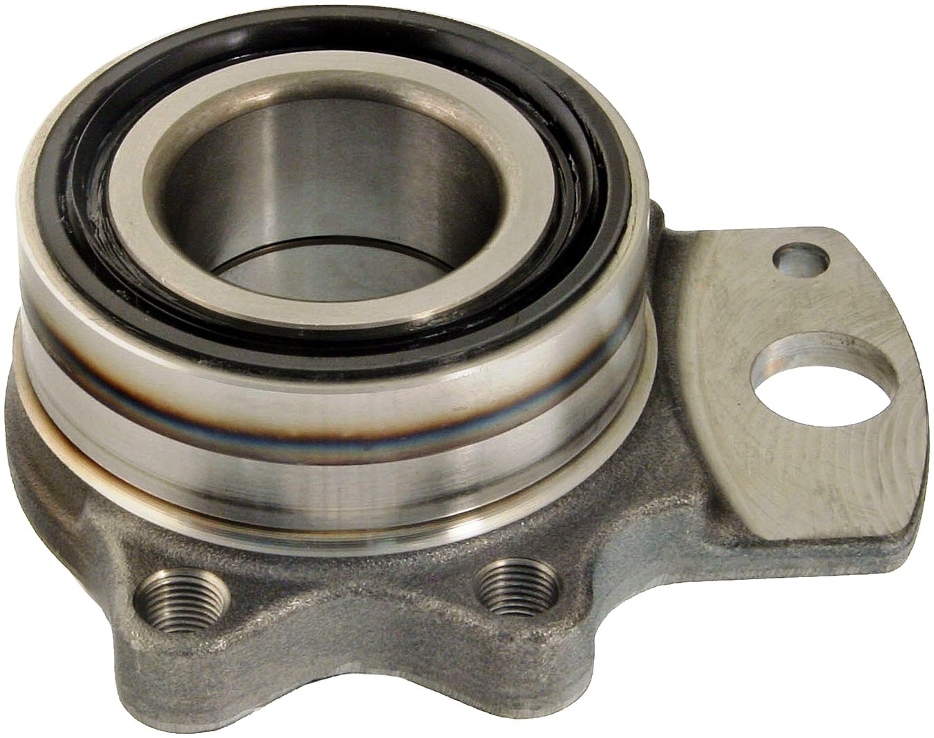

socorob Posted July 6, 2018 Author Share Posted July 6, 2018 See how the top one has 2 small holes and the bottom one has 1? Mine only have 1 hole with a stud in it. Just by looking, I can't tell any other differences. Quote Link to comment Share on other sites More sharing options...
