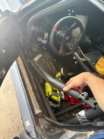

FastFloridian Posted July 26 Author Share Posted July 26 Started cutting on the dash to see how it will fit, roll cage goes through it. Now I need to mock up the digital gauge display and see how it will fit. Displays is bigger than dash think it needs to Poké above dash as steering column looks to sit too close below. Too hot out, done for the day. Quote Link to comment Share on other sites More sharing options...

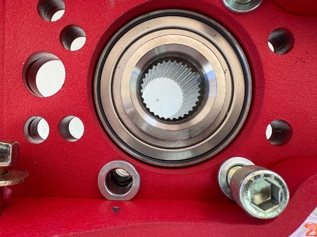

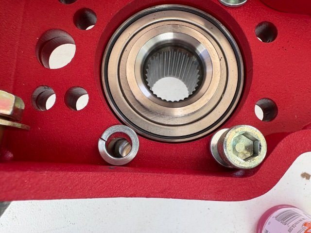

FastFloridian Posted August 16 Author Share Posted August 16 Heat advisory today, and I believe it, damn it’s hot. Started off replacing studs with APR extended studs then attaching 370Z wheel bearings to the custom spindle, did all that in the AC. Then to the outside, unboxed all the front suspension and got subframe, new plate for control arms and upper control arms up. Stupid plate was near impossible to install. It’s perfectly shaped to frame, bolt holes don’t align when carriage bolts are up, and plate doesn’t align and fit on when carriage bolts are down. Took forever halfway adjusting it, having my dad tap carriage bolts from top while I’m holding and aligning from bottom. Nightmare, but finally got it on. Hopefully the rest will go smoother. Did I mention I’m exhausted 1 Quote Link to comment Share on other sites More sharing options...
FastFloridian Posted August 16 Author Share Posted August 16 Here’s a few more pics of that plate with the impossible carriage bolts, I circled where they are. They definitely could have designed that better. 1 Quote Link to comment Share on other sites More sharing options...

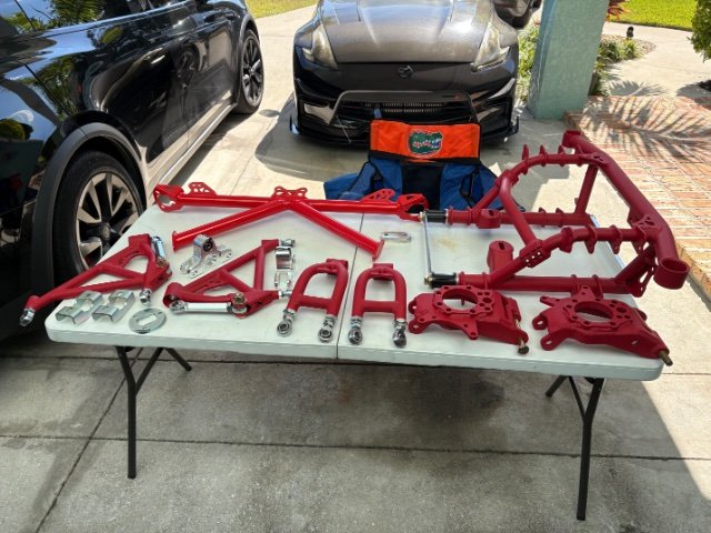

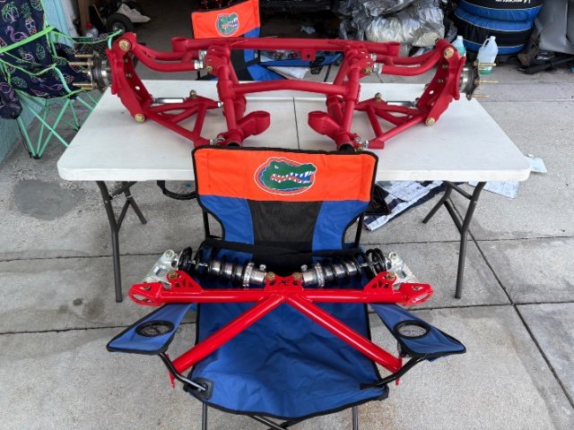

FastFloridian Posted August 17 Author Share Posted August 17 (edited) Got a few more things on today. This kit has tons of adjustability, just making some initial guesses on caster, bumpsteer, etc. a little bit of a puzzle with the hardware, some things you only needed if keeping stock subframe or other stock parts. I hope to have the rest installed next weekend. Edited August 17 by FastFloridian 1 Quote Link to comment Share on other sites More sharing options...
FastFloridian Posted August 19 Author Share Posted August 19 Jam nut for toe arm came in, dumb that it’s the only hardware that doesn’t come with the kit. New brake lines came in too. I might take this Friday off to finish up the suspension, and hopefully start on brakes. 1 Quote Link to comment Share on other sites More sharing options...
FastFloridian Posted August 22 Author Share Posted August 22 Took the day off to work on the car. Got the front suspension almost complete. Was going to do brakes, but I didn’t get the caliper bolts, thought they came in my BBK. Got those ordered, so should get them on next weekend. Quote Link to comment Share on other sites More sharing options...
