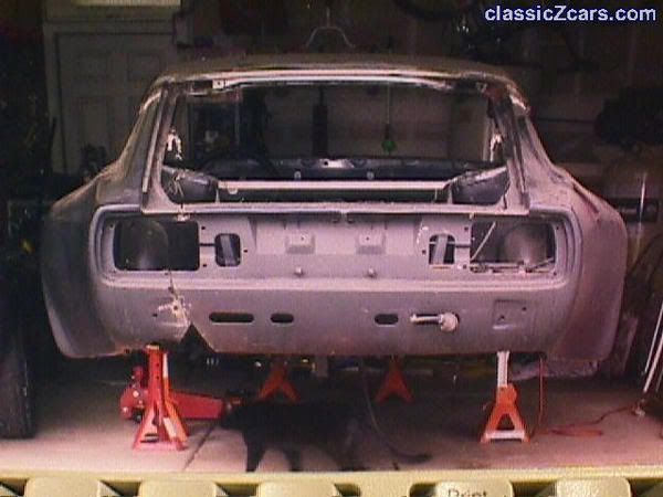

Ok, lot of posts but now I have finally reached a result. Dan, the aforementioned guy above (powdercoating) will make as little as six sets of rear quarter panels (huge IMSA flares as seen in these pictures) for $400 per set INCLUDING SHIPPING IN THE CONTINENTAL US. This does not include the front fiberglass fenders as yet, only the rears. He owns a bodyshop and has made these before and actually has a set of them on his own car as well. He also has some front fiberglass flares he might mold onto a set of fiberglass fenders but we are just in the talking stage on that right now.

Dan is not a powdercoating guy, he is a paint and body shop owner here in AZ. He would also like to remind everyone that these flares have been configured for his car that has been back halved and fitted with a Ford 9" rear end. He is also not sure of the end cost for the package.

Ok, I just talked to Dan today (dmsv8) and this is what he told me. He thinks the powdercoating guy is also named Dan and that he bought the big molds from Arizona Z but is located in Ohio. This Dan owns a body shop (which I knew) and lives in Phoenix. The confusion started by the same names and the fact that he has built and cleaned up molds for Arizona Z even though they were eventually sold elsewhere (Dan in Ohio). Because of this, he got a set of the flares and put them on his car and has the knowledge and facilities to create a mold of them and make duplicates for us if he eventually makes that decision based on the interest level here. He still says his target price, including shipping is $400 and wants me to continue to use that figure. We all know it could change when he actually begins the project, if he does, and we all also know that changes in price usually go higher, not lower. 280zone is an actual live friend of his in the same town so if anything he says goes against what I am saying in this forum; I would defer to him as he should have the lastest or most accurate information compared to mine. Dan said he has already received emails and calls with interest; so keep it up and lets make it worthwhile for him if we can. Also he wants everyone to know that he has altered the outside edge of the wheel opening of the flares to accommodate huge (tall) tires because his car is tubbed, etc., and that a little fibergalss might have to be added to conform to your own wheels.

Yes, you are so right; and now let's find the full front fiberglass flared fenders that came with these and the gnose as a kit. I've also learned that if you go to the home page, select Albums, select Member's Galleries, then go to the page where you find dmsv8 and click on that, you will see Dan's flares.
By the way, Zlalomz, who has the set in your photos?

I put up a few more shots of my quarter panels.From the body line down to the wheel opening is 13 in. From middle of front axle to the front of the wheel opening is 77 and 5/8ths. From the middle of my front axle to the middle of rear axle is 92 and 1/2 inches. The rear wheel opening is 30 inches. Any questions feel free to email me. dmsv8@netzero.com
