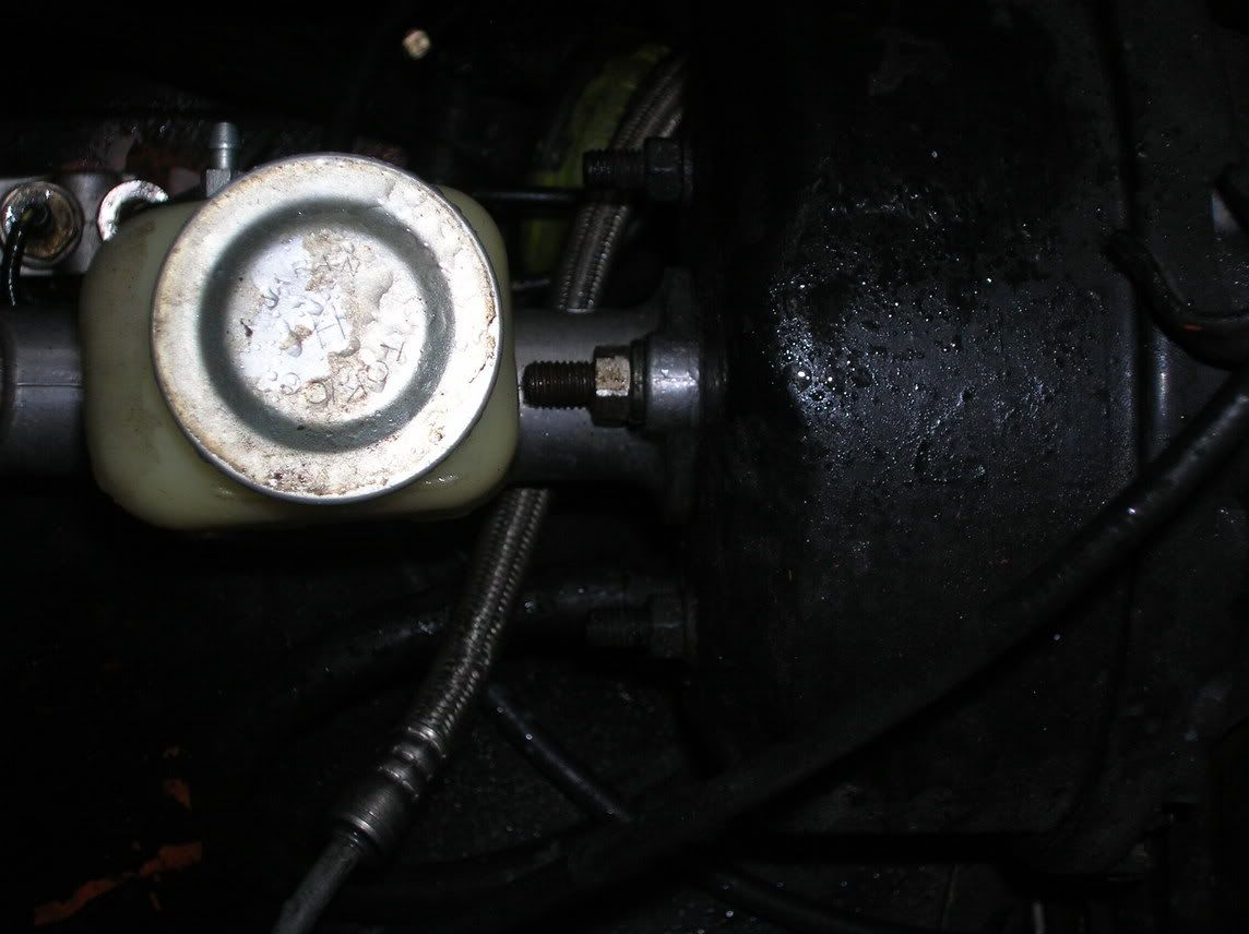

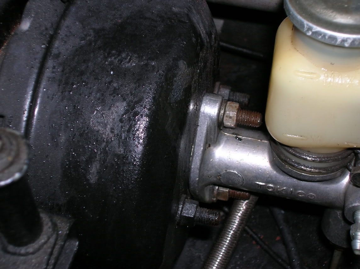

Wait just a minute. On my 240 there is a spacer that has the mounting holes on the sides, and that spacer has studs on top and bottom. I don't think you can bolt up the master without the spacer. I wonder if your PO used a different master and had to get rid of the spacer because it wouldn't bolt up with it on. Any pics?

My daughter uploaded the pics to her account on an image hosting site. Since they are large, she will post links to them.
http://img.photobucket.com/albums/v205/stealmeastar/240zbrakes003.jpg
http://img.photobucket.com/albums/v205/stealmeastar/240zbrakes002.jpg
http://img.photobucket.com/albums/v205/stealmeastar/240zbrakes001.jpg
a picture is worth a thousand words. thanks for the help

well spacer is obviously missing so i went under dash and backed off rod that attaches to brake peddle by 4 turns took her out and same result as before...locked up brakes...this time though i bled the caliper and you could here the brake disengaging. by the looks of it i believe previous owner used used parts from a junkyard to do conversion( why try to save money on brakes??!!).so my question is now this...should i just replace calipers with new( cost from autozone is around $35-$40 each) and which calipers do i have? my rotor is not solid so does that mean i have to get a later model toyota caliper then the 79-85 years. the stamp on the side of my caliper is S12-8. actually replacing the calipers at this point is a forgone conclusion as well as brake lines. since i have already replaced master and proportioning valve i might as well complete the job right and avoid any further problems with braking due to old parts and stinginess. i just want to make sure i order the right calipers from the get go so i can put this headache to rest! after all, when all is said and done stopping is THE MOST important part of going.
I suggest you also need to adjust the pushrod lenght at the booster by removing the master cylinder. The pushrod end should have threads and a hex area for adjusting. If the pushrod length is too long because you're missing the spacer, no amount of underdash adjustment will help. Maybe you can make a master-to-booster shim that uses as much of the master cylinder mounting threads as possible to creats more space between the pushrod and the master. Again, when this is right you can test the effects by being able to push the caliper piston into the bore (and pushing the brake fluid into the reservoir). You probably can't do that now with your current adjustment.
Oops, yeah I think Peter is right. There is the adjustment between the pedal and the booster, then there is a second rod between the reaction disc and the back of the master. So you would have to take the master off the booster, pull the pin and look at it. Maybe you can adjust it there, maybe you can modify it, maybe you'll have to get a spacer. The reaction disk is a little rubber disk. If it falls out of it's little spot you'll be chasing all kinds of other problems, so make sure you put it back in if it falls out when you're messing around in there.
