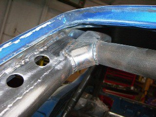

74_5.0L_Z Posted October 22, 2008 Share Posted October 22, 2008 Looking good Jon. I especially like the routing of the tubes to the front strut towers. Quote Link to comment Share on other sites More sharing options...
JMortensen Posted October 22, 2008 Author Share Posted October 22, 2008 Thanks Dan. I wanted as much 3 dimensionality as I could get, if that makes sense, so I went as low as possible on the A pillar. At this height I had to dent the fenderwells a bit for clearance, and was right at the bottom of the fenderwell to firewall junction, so that's about as low as I could go. I wish I could have made the tubes hit the strut tower directly, but about 1" away from the strut tower was the best I could do. There just wasn't any room to weld. I think if I had done these first and then the tubes to the dash bar it would have worked. Again, live and learn... Quote Link to comment Share on other sites More sharing options...
