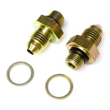

I just ordered a 1/8" BSP to -4 AN adaptor and the BSP end is way too small of a diameter to thread into the Nissan T on the side of the block. There is a lot of slop. I have the -4 stainless line so the other end fits the line perfect.
Did I get the wrong part? This is the only British adaptor they have available...
http://www.atpturbo.com/Merchant2/merchant.mvc?Screen=PROD&Product_Code=ATP-FTG-033&Category_Code=FTG
For the turbo side, I got the aluminum T3 plate they make, a 0.060 restrictor, and adaptor to go to the -4 AN line. All looks good on that end.
You got the wrong fitting. The block is acually BSPT 1/8 27 TPI. It is a tapered fitting that seals by interference fit. The fitting you have there is a straight thread BSP 1/8 fitting that seals with a oring.
