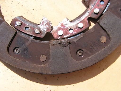

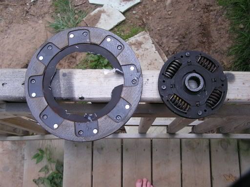

Drax240z Posted April 13, 2006 Share Posted April 13, 2006 Just got off the phone with spec... very friendly shisters.... I told them my story, 280ish ft/lbs of torque, take to the drags twice a year, and 15,000 miles of freeway driving. They said, I don't doubt you, these clutches are finiky and that I should be satisfied with that amount of mileage. As speeder showed, these are no good for drag use, and as I have shown, no good for street use. Just to throw another angle on this... I've been using a CFDF with 280ft-lbs of torque, have 22,000 miles on it, 3 seasons of autoX and some spirited drag race lauching (no slicks, just R compounds) and it's held up fine so far. I've slipped it, dumped it, broken stub axles, broken half-shafts, etc. No issues. There are plenty of people with failures of the CFDF with much less abuse, from reports here. Perhaps their QC isn't consistant, perhaps its due to break in and installation procedures. Either way, with the response you recieved from SPEC I wouldn't buy one! CF sounds about the same too. So, is ACT the only option? How are Exedy products? What is a guy to do with a powerful L-series? (not that I have one) Quote Link to comment Share on other sites More sharing options...

Guest SPEC01 Posted May 23, 2006 Share Posted May 23, 2006 Hey, I was just roaming around here in the forums and noticed this post. I work here at SPEC and am interested in providing everyone with as much information as i possibly can. From the looks of the unit there appears to be a bit of contamination. I will however be more than happy to check this issue out further if you would contact me directly. I can get it in here and thoroughly inspect the item, thus determing the nature of its failure. You or anyone else can contact me directly: justin@specclutch.com 1.800.828.4379 Ext 108 I will be more than happy to help anyone here on the forums or anyone else that you know who have any other issues with our product. Thanks, Justin Quote Link to comment Share on other sites More sharing options...

speeder Posted May 25, 2006 Author Share Posted May 25, 2006 From the looks of the unit there appears to be a bit of contamination. I will however be more than happy to check this issue out further if you would contact me directly. I will be more than happy to help anyone here on the forums or anyone else that you know who have any other issues with our product. I've already placed my old clutch setup where it belongs - in the dumpster. Considering the reputation of this vendor, along with making the assumption that any competition use is not warranted, I felt that I would be wasting my time trying to get some satisfaction from SPEC - At this point I doubt that anything can be done with their pieces to suit my needs. I had a Stage 3 (without the double diaphragm PP) setup installed before the G-force T5 went in, and it didn't look too good when removed - The guys at Spec recommended upgrading the PP with the new install, which I did. I know how to check/set up hydraulics, as well as to how avoid contamination. I've had no problems - other than the expected signs of hard use - with other brands of clutches. Sorry to keep trashing, but spending money to do things over, not to mention replacing clutches, tends to make a fellow cranky. Quote Link to comment Share on other sites More sharing options...
