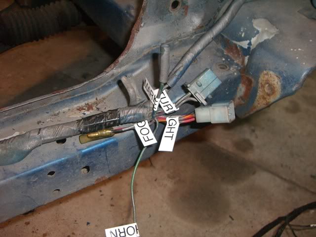

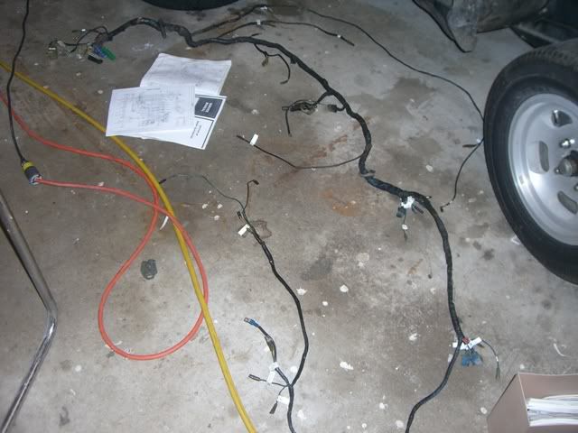

bjhines Posted April 5, 2006 Share Posted April 5, 2006 I case you ever wondered why your headlights go dim, strange things happen in the rain, etc, etc.... I present to you "SPLICE WARS" Nissan just didn't use solder... at all..... I am going to apply solder liberally throughout the car... engine harness before unwrapping. After unwrapping I'll be damned... FOG LIGHTS!!! Headlight splice.. kind of exposed if you ask me.. I dont like it at all... Soo this is why my horns didn't work... someone pulled too hard. How nice.. splices with extra wire!!! Fuse panel fully soldered... It took a bigass iron on one side and a little iron on the other... with lead solder in my teeth... I am adding relays for everything... but I thought I would show you guys what I found..... Typical ground splice. It had been very hot and melted the tape and browned the main power+ right next to it.... whew!!! Quote Link to comment Share on other sites More sharing options...

2003z Posted April 6, 2006 Share Posted April 6, 2006 You haven't lived until you've torn apart and fixed the wiring in these things. I did it to my last one, tracing and labelling every wire. It was a nice 2 week project. I spliced to junkyard harnesses into one complete one. Quote Link to comment Share on other sites More sharing options...
clint78z Posted April 6, 2006 Share Posted April 6, 2006 ACtually many cars have splices, very common older way of doing it. If you solder that connection it will eventually work harden the copper over the years and it will rip the copper starands off. Metripack connnectors are the way to go on connections outside the car. Quote Link to comment Share on other sites More sharing options...
bjhines Posted April 6, 2006 Author Share Posted April 6, 2006 That is a very good point Clint... I have a great deal of experience with low voltage electrical systems... I build TV studios for a living... Often clamp type connections are better than solder in situations where things need to be flexible or removable... but the connections I am soldering are going to be permanently mounted and will not suffer from flexing very much... Quote Link to comment Share on other sites More sharing options...
