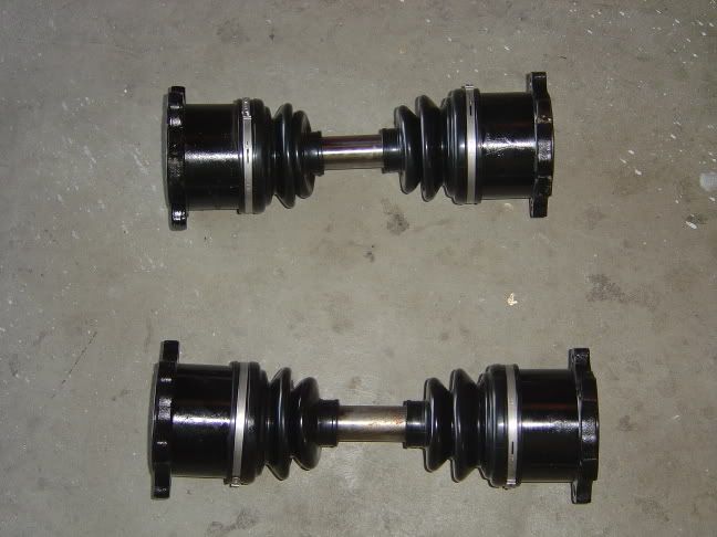

We finished the axles, brake line was fixed.Installed the driver side axle and we are having clearence problems with the passenger side one.We have to raise the differential a little to get it to clear the control arm.We spent lots of time going back and forth to buy small parts needed.Hopefully we should have it done next week.

I will be swaping the oem control arms for some Arizona ones, They should give us some clearence and after raising the differential, I think well be fine.
