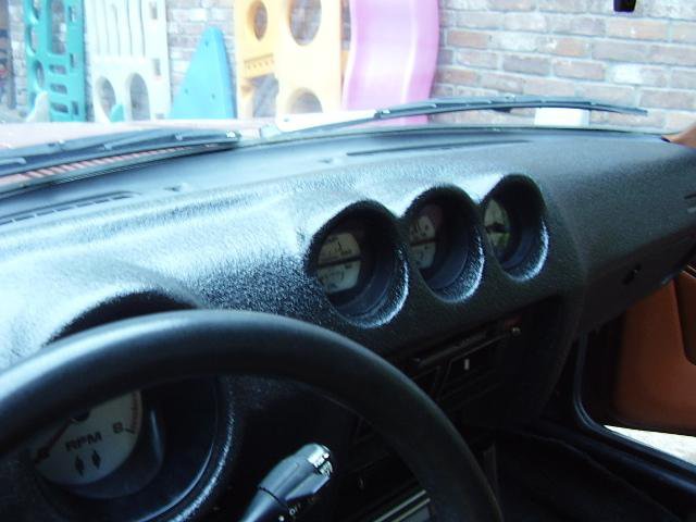

I promise, I'll have something really really interesting to show on Monday. How well this idea will turn out, I have no idea....
Wow, you didn't disappoint either! The dash looks great! Strange idea turns out to be one that absolutely rocks; go figure. I think you got your money's worth, friend! :2thumbs:
Davy
The glare was bad the first day, but as time goes by it's loosing it's sheen. I didn't get a chance to weigh it, but I would say it's about 4lb-5lb heavier.

Yeah I did my dash about a year and a half ago w/herculiner. Looks almost just like yours and it's holding up great. I had patched / repainted it before but it never held up for a long period of time. The herc. is strong/flexible enough that it should last basicly forever.. And you can't beat the price.. If anybody else dose this.. Dont use the cheap duplicolor or other bedliner. The Herc is good and cheap at about $20 quart. I put on 3 thick coats and still have over half left. You can reduce the glare by controling the xylene cut or just brushing it when it's almost cured.

Got a chance to see this car in person tonight. The dash is AWESOME!! Definately going that way with my dash. His bodywork is coming along great, just enough filler to do the job. Going to be a SWEET ride when he's finished..... NOW, about that V8 swap...lol.
