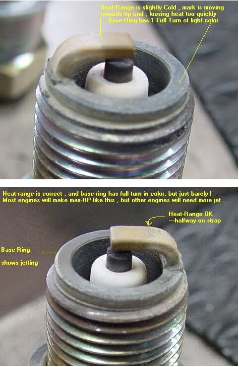

Administrators RTz Posted August 30, 2006 Administrators Share Posted August 30, 2006 My understanding is that the heat range of a plug only affects the temperature of the center electrode and insulator. Sam, I respectfully disagree. The ground strap, if the proper heat range, will indeed run hotter. Taken from Champion spark plugs.... "If you make modifications such as a turbo, supercharger, increase compression, timing changes, use of alternate racing fuels, or sustained use of nitrous oxide, these can alter the plug tip temperature and may necessitate a colder plug." Also, the way I understand choosing the right temp range is shown in the below pic... This clearly illustrates the ground strap running hotter. Twenty bucks says Braap is right Quote Link to comment Share on other sites More sharing options...
Sam280Z Posted August 30, 2006 Share Posted August 30, 2006 Learn something new every day. It sure looks like my understanding was incomplete... Now I'm curious as to why... I don't make bets unless I'm certain I will take your money. I especially don't make bets when I certain you will take mine Sam Quote Link to comment Share on other sites More sharing options...
