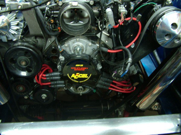

Bartman Posted October 3, 2006 Share Posted October 3, 2006 On the way home from the JCCS on Saturday my engine died on the freeway. I went to switch on the air and the engine died on me (I knew it might, because the idle speed with the A/C on is still too low), but I expected it to start again afterwords. Well it wouldn't start, and I wound up getting it towed home. I thought it would be something simple, but I still haven't figured out the problem. It will crank, but it won't fire. It's getting fuel and the Check Engine light is on when the ignition is on and when it cranks. I hooked up DataMaster to try and see what's going on and it can establish communication with the PCM when the ignition is on, but as soon as it cranks it loses communication with it. As soon as you stop cranking, DataMaster can again communicate with the PCM. I had a similar problem when I first wired in my PCM using an ignition hot wire that wasn't hot when cranking, but I fixed that a long time ago. I checked the iginition hot wire going to my PCM last night and it is still hot while cranking the engine. I'm in the process of checking all my wiring, but I thought I would see if anyone has any ideas of what could be happening. 1 Quote Link to comment Share on other sites More sharing options...

Bartman Posted October 4, 2006 Author Share Posted October 4, 2006 Thanks for all the information. It looks like DataMaster losing the connection to the PCM while cranking is normal, and not a sign of a problem. I checked my wiring to the PCM and everything looks good (constant power, switched power, and I've already run all my PCM grounds to the battery and have a good grounding strap from the engine to the chassis). The A/C has been off since the problem first started. I also checked for spark at the plug and at the coil, and although I do have spark it doesn't seem to be very strong. More information: The morning that this problem started, the CEL was on and I didn't have time to check for codes before the car show, so I don't know what code was being thrown. It ran pretty good, but it did buck a little bit at very low RPM conditions while driving in traffic. After it died I couldn't hardly even get it to crank at all. I had my cables with me and I got someone to stop and give me a jump. It would crank and it backfired but it would not start. It seemed like the timing was off or something else electrical related. When you try and start it and stop cranking the engine will continue to turn over for a short time, but very slowly (almost like it is dieseling). When I rebuilt and upgraded the top end I also upgraded to a vented opti, but I put in a used one that I got from eBay. So it could be an opti problem, but I don't want to just throw parts at the problem. If I can isolate the problem as the opti I have no problems buying a new one. Quote Link to comment Share on other sites More sharing options...

Bartman Posted October 5, 2006 Author Share Posted October 5, 2006 Well surprisingly enough, my opti and spark checked out okay with the shbox tests. I'm kinda stumped now. I still think the spark looks a little on the weak side...any suggestions? Quote Link to comment Share on other sites More sharing options...
