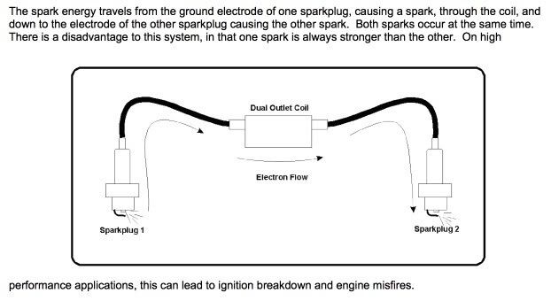

Administrators RTz Posted October 24, 2006 Administrators Share Posted October 24, 2006 This thread has progressed to the point that I think this needs to be mentioned. The primary drawback of dual-post coils is that it puts the spark plugs in series. This means their polarity is opposite each other. See Below... Courtesy Wolf... This has been hashed out here... http://forums.hybridz.org/showthread.php?t=114147 However, I agree with Pete... for 99% of applications its perfectly adequate. The weaker spark is still more than sufficient most of the time... I know of people running over 20psi on dual post coils. Quote Link to comment Share on other sites More sharing options...
