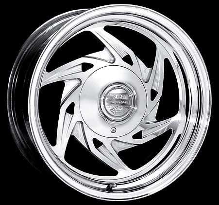

ZZZeee Posted December 20, 2008 Share Posted December 20, 2008 This is for an old Alpha 1. If I install 5-lug adapters that are 2" thick on all four wheels is the correct wheel backspace then 5.5" all the way around for 8" rear wheels and 6" front wheels? http://www.skulte.com/product_info.php/cPath/21/products_id/56 Better and/or cheaper 5-lug solutions anyone? Quote Link to comment Share on other sites More sharing options...
Boy from Oz Posted December 20, 2008 Share Posted December 20, 2008 ZZZeee - I'm not sure what outcome you are after which makes it very difficult to advise. If you are after an original look, the 1962 GTOs had 5.5" front and 6.5" rears but the '63-'64 models went up an inch to 6.5" and 7.5" respectively. They were probably the first to run external offset to clear the brakes or to keep the brakes cooler - compare the offset to other wire wheel cars of the era. Many of the the GTOs racing today are clearly going to much wider rims for races. http://www.supercars.net/cars/518.html (see gallery). I have just ordered a pair of 7" reverse-laced triple-cross wheels from Dayton Wire Wheels. I am hoping I can get away with a 6"-7" combination but I may have to go with a 7"-8". Either way I need the 7" so I have started there. I am widening the rear track to suit the narrow rear wheels so my dilemma is with how the narrow rims will look on the front. I should know in a few weeks. On their site http://www.daytonwirewheels.com/ they have a template which allows you to input caliper, spring and guard lip positions, etc, to get a cross-section perspective of your wheel/tyre and backspace options. http://www.daytonwirewheels.com/pdf/dwwmeasurementguide.pdf Here are a further couple of good sites to help you. http://www.rims-n-tires.com/rt_specs.jsp http://www.carbibles.com/tyre_bible.html Spacers are illegal down here so they are not an option for me. Quote Link to comment Share on other sites More sharing options...
ZZZeee Posted December 20, 2008 Share Posted December 20, 2008 Boy from Oz... Thank you for the informative post. I want to run 6" rims in front and 8" in the rear. I'm not even going to try for the correct look because I just can't afford the Dayton spokes. Instead, for now at least, I'm just going for a 60's period look with some nice used lightweight aluminum wheels. My goal is to get the backspacing correct to properly fill these wide fenders. The offset on the current wheels look completely wrong. They don't even come close to filling the fenders properly. Quote Link to comment Share on other sites More sharing options...
Boy from Oz Posted December 20, 2008 Share Posted December 20, 2008 I know what you mean about the cost and I had to pay exorbitant freight cost on top of that - funny how freight cost go up when oil goes up but doesn't come down when the oil price comes down. You should see what this exercise is doing to my wife's bank account! I know larger external offset are not popular these days with cast wheels but have you considered composite wheels where the rim is attached with multiple bolts and setting them up with reversing the rim. http://www.simmonswheel.com.au/ I'm sure there would be something like this in the States. Also, way way back in my youth we often removed the wheel hub/centre from the rim and reversed the rim. It was easy to do with steel wheels but with alloy welding so good now is that an option for you? Quote Link to comment Share on other sites More sharing options...
ZZZeee Posted December 20, 2008 Share Posted December 20, 2008 ... Boy from Oz said: I know what you mean about the cost and I had to pay exorbitant freight cost on top of that - funny how freight cost go up when oil goes up but doesn't come down when the oil price comes down. You should see what this exercise doing to my wife's bank account! Hah!! Yeah... all businesses will use any excuse to charge more siting some unforeseen and unusual situation then conveniently forget to lower their fees once things normalize. It's called greed, my friend. Alas... no wife here from whom to drain her bank account. I know larger external offset are not popular these days with cast wheels but have you considered composite wheels where the rim is attached with multiple bolts and reversing the rim. http://www.simmonswheel.com.au/ I'm sure there would be something like this in the States. Two-piece wheels are fine. I'll take a look. Also, way way back in my youth we often removed the wheel hub/centre from the rim and reversed the rim. It was easy to do with steel wheels but with alloy welding so good now is that an option for you? I'm not doing my own work and I can't weld so this type of thing would be hired out. I'll bet I can sell the old wheels and buy some used ones with a better fit for what the labor would cost. I've been searching and I think I can buy all four wheels for less than $500 delivered. That "might" even come close to paying for some really nice used properly-sized tires too. So do you think I'm pretty close on the backspacing? BTW, the front tire height will be 26-27" and the rear will be 28-30". The springs will be changed for the proper ride height. Quote Link to comment Share on other sites More sharing options...
Boy from Oz Posted December 20, 2008 Share Posted December 20, 2008 Alas... no wife here You should be able to afford a real GTO then! So do you think I'm pretty close on the backspacing? I might have this completely wrong but I think your backspacing is a bit off. For a start, is it possible to have 5.5" backspacing on a 6" rim? The front GTO panels, as I understand it, are wider than the OEM Datsun panels so you need less backspacing to compensate, otherwise what is the point of the spacers. I'm not really sure what backspacing you need but again suggest you work through the Dayton template - it's applicable to all wheels not just Daytons. The springs will be changed for the proper ride height. Make sure you address the bumpsteer issue if you alter the ride height. Also, have you checked eBay or other places for used Daytons or cheap Chinese made wire wheels. Wire wheels are just so in character with that car. Quote Link to comment Share on other sites More sharing options...
ZZZeee Posted December 21, 2008 Share Posted December 21, 2008 ... Boy from Oz said: Alas... no wife here. You should be able to afford a real GTO then! No extra "wife" income to sponge from. So do you think I'm pretty close on the backspacing? I might have this completely wrong but I think your backspacing is a bit off. For a start, is it possible to have 5.5" backspacing on a 6" rim? The front GTO panels, as I understand it, are wider than the OEM Datsun panels so you need less backspacing to compensate, otherwise what is the point of the spacers. I don't know. I'm working from what I've read here (3.5" all the way round) and subtracting for the extra 2" for the 5-lug adapters. I don't care about the "spacers" it's those 5-lug adapters that add that those extra 2" and it's why I asked about better alternatives. I'm not really sure what backspacing you need but again suggest you work through the Dayton template - it's applicable to all wheels not just Daytons. I'll work through Dayton's guide. The springs will be changed for the proper ride height. Make sure you address the bumpsteer issue if you alter the ride height. Also, have you checked eBay or other places for used Daytons or cheap Chinese made wire wheels. Wire wheels are just so in character with that car. As much as I "HATE" FleaBay, I'll take a look. Do the Chinese versions break??? Quote Link to comment Share on other sites More sharing options...

ZZZeee Posted December 28, 2008 Share Posted December 28, 2008 Another wheel question... please don't blast me for not getting spokes... I can't afford them. If I use these adapters (2" thick): http://www.skulte.com/product_info.php/cPath/21/products_id/56 Will these wheels be a good fit on the rear of an Alpha 1?: http://store.summitracing.com/partdetail.asp?autofilter=1&part=CLL%2D055907547&N=700+400056+300312+4294923105+4294793325+4294795022+4294919982+4294755960+115&autoview=sku Front rims: http://store.summitracing.com/partdetail.asp?autofilter=1&part=CLL%2D055704547&N=700+400056+300312+4294923105+4294755960+4294793325+4294794966+4294795102+115&autoview=sku Rear tires will be 28-29" tall and 10.5-12.5" wide. Fronts will be 26-27" tall and 6-7" wide. I want the final fitment to look as as though they "belong" on this car even though the wheel style is completely wrong. I'm tired of the current wheels not filling the fenders. Quote Link to comment Share on other sites More sharing options...

mclark999 Posted December 30, 2008 Share Posted December 30, 2008 ZZZeee said: Another wheel question... please don't blast me for not getting spokes... I can't afford them. If I use these adapters (2" thick): http://www.skulte.com/product_info.php/cPath/21/products_id/56 Will these wheels be a good fit on the rear of an Alpha 1?: http://store.summitracing.com/partdetail.asp?autofilter=1&part=CLL%2D055907547&N=700+400056+300312+4294923105+4294793325+4294795022+4294919982+4294755960+115&autoview=sku Front rims: http://store.summitracing.com/partdetail.asp?autofilter=1&part=CLL%2D055704547&N=700+400056+300312+4294923105+4294755960+4294793325+4294794966+4294795102+115&autoview=sku Rear tires will be 28-29" tall and 10.5-12.5" wide. Fronts will be 26-27" tall and 6-7" wide. I want the final fitment to look as as though they "belong" on this car even though the wheel style is completely wrong. I'm tired of the current wheels not filling the fenders. Go to Centerline Wheels website. They have several options that fit the Z 4 lug pattern and can custom offset what you want. Some of the options actually look nice on a GTO. I photoshopped a couple. Quote Link to comment Share on other sites More sharing options...
