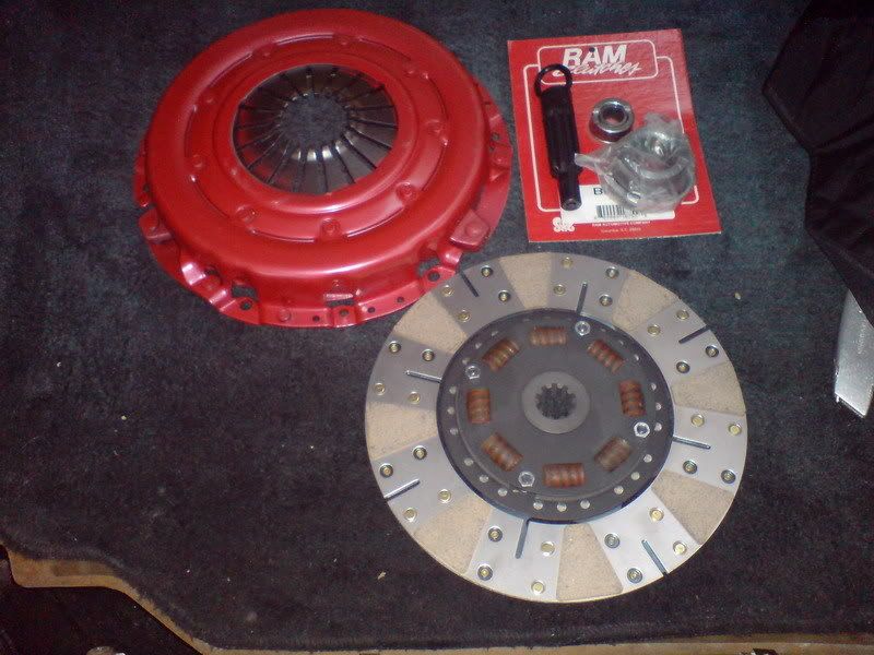

MY77Z Posted June 11, 2007 Author Share Posted June 11, 2007 well, i dont want to start a new photos thread of my car so i'll just post them here, few weeks ago, i bought a new clutch setup and modified the SC to make it fit, MC, SC, hose and fittings new RAM powergrip HD clutch kit out of the box installed after few modifications another one this is it for my clutch upgrade. now i'm working on my cooling system, got new high flow water pump, griffin 24*19 radiator, 160degree t-stat, swivel t-stat housing, i'm trying to do my best but got no time to work on the car because of my job. thanks Quote Link to comment Share on other sites More sharing options...

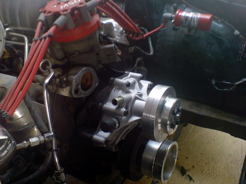

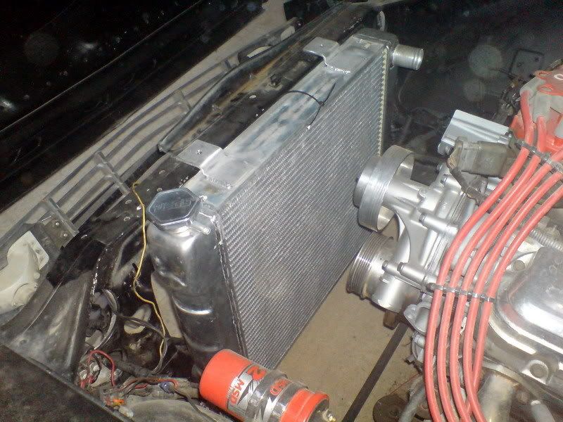

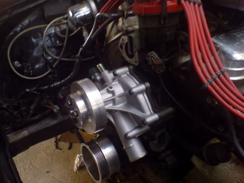

MY77Z Posted June 13, 2007 Author Share Posted June 13, 2007 hi guys, i had few hours to use yesterday and i installed the new water pump, cleaned the surface around it and painted it in gray, modified the alternator bracket and painted it too, had the radiator mounts fabricated and welded on the rad. i'll use some 4mm rubber piece under the mounts not to mount it directly on the body, my only problem now is the Electric Fan, it will not fit easily between the rad and the crank pully, the only way to make fit now is to mount it more to the drivers side and not in the middel, i thought about cutting few mm from the crank pully but i dont think its a good idea. what do you guys think? Quote Link to comment Share on other sites More sharing options...
stangracr Posted June 13, 2007 Share Posted June 13, 2007 I would just mount the fan slight off center then. Shouldnt cause a concern. Just noticed something in your picture. You are running the waterpump pulley on the backside of the belt right? I can see where the belt has run on the grooved side before. This has probably been adressed before. Gotta run a late model pump on the backside of the belt so it will turn the correct direction. My 331 is ready to go into the Z. Gotta get my sons GT completed first. Its near starting just waiting on a new flex plate. Got sent a 157 tooth one and need a 164 tooth. I will let ya know how the SSI intake works out. It is more of a pain to assemble then other intakes thats for sure. I will have my son post some pics of the job on his car too. ed Quote Link to comment Share on other sites More sharing options...

MY77Z Posted June 14, 2007 Author Share Posted June 14, 2007 hi Ed, well my Water pump is a highflow pump that turns both directions, clocklwise and counterclockwise, so i dont think its a problem anymore and BTW, your son's engine looks great, good job on the install. keep up the good work Quote Link to comment Share on other sites More sharing options...

MY77Z Posted June 26, 2007 Author Share Posted June 26, 2007 good news i've just finished installing everything in the car, the fan is a pusher now, fired the car for 20 minutes maybe without driving it, the temp didnt go over the middle ( i dont have numbers on my guage) when i used to drive it before, while running, the temp was at 3/4. so i guess it will drop more now when i run. i'll post some photos tomorow. Quote Link to comment Share on other sites More sharing options...

quicker240 Posted July 4, 2007 Share Posted July 4, 2007 First off,the car looks great.I ,like somebody else posted earlier,am concerned about the fan belt.You are gonna have to add an idler or tensioner pulley somewhere to get the ribbed side of the belt off of the water pump.It will slip like crazy and burn up the belt in a matter of hours,if that long.In Kuwait,I know I would'nt take a chance.Probably be OK for a test drive,but no more than that.The back side of the serpentine belt should ride on the water pump pulley.Good luck! Quote Link to comment Share on other sites More sharing options...
MY77Z Posted July 4, 2007 Author Share Posted July 4, 2007 thank you for the nice words, well about the belt, i used to drive my car before installing the clutch and the cooling system with the same belt setup as now, drove it for maybe a month without problems, and flooring it whenever i can never slipped even with nitrous. and when i took it off, the belt looked like new. i guess i'll be driving it like this for now, if it starts to be a problem, i'll install a pully on the driver's side. Quote Link to comment Share on other sites More sharing options...
